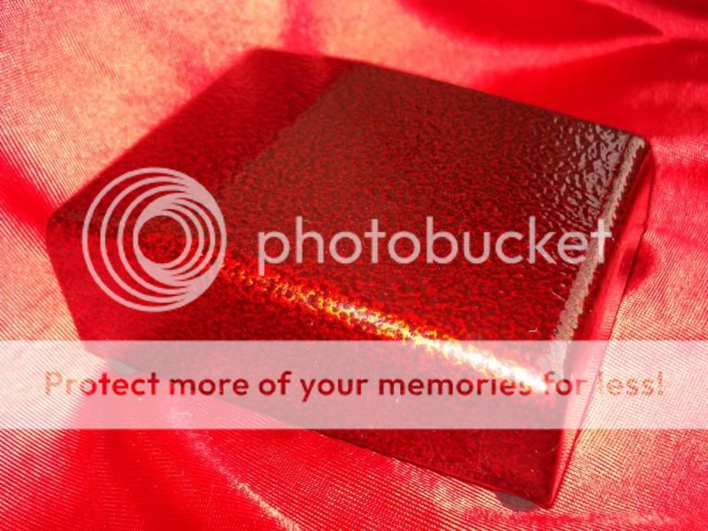

sinner wrote:Yeah, pedalenclosures.com is the hottest shit on the plane
HA....i cant stand them. The YYs are always too thick and I cant get pots to stay in em well. Sure I could order different pots, but thats aggravating.
It's just a pots bro :D YY's are coolio, I wish Mike will make them twice as wide as they are right now one day
The new one looks cool, the big ones, the only ones I never had... yet... I wonder do they're big enough to fit CE-1 Chorus replica board Im working on - this type of enclosure would be perfect for chorus ensemble repro project
Anyway, talk to Mike, he's really great person
