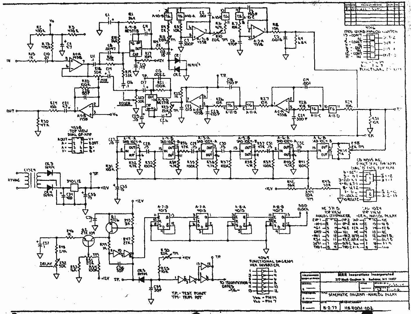

Hello there.
I am Steve from just outside London England and am having one hell of a time getting any repair info on an old MXR 118 analog delay,the unit is as dead as a dodo,well not quite but no sign of any clock pulses etc,does anybody have any advice re this old classic,are there common faults, and i understand there is more than one version of the PWB assy used in these old

My MXR Analog Delay is currently at the tech for fixing, and he's having some trouble with it. It was modded for an LED and possibly messed with in other ways.
Its the earlier SAD1024 version with just two outputs and obviously worth fixing. Apparently "getting the main clock functioning" is the first issue. Possibly he could consult here? Thanks - PT.

Here's the schematic for the sad1024 version
https://i206.photobucket.com/albums/bb1 ... gdelay.png
I would ceck first the power supply section: first ceck if the transformer is working properly, then ceck the diodes and the voltage regulator (probably is dead) .Due to the fact that this is an old pedal i would even replace all the electrolytic capacitors. If this section of the circuit gives you a 12VDC regulated power supply then i would ceck the Clock section: the dual flip flop (CD4013), Q1 and Q2. In the meantime check all the wires, bad solder joints and traces.
If the clock works properly and you've got only dry signal out of the box, use a probe to see where the wet signal gets lost.

This was supplied in the thread I started earlier
I think analogguru sheet may be for the later version, as it appears to have three jacks.
Steve and I would appreciate any and all help.

Thanks very much for that Matteo, I passed that on to Steve, plus your suggestions, and he's now started a new thread so this one should probably now divert to that one.
