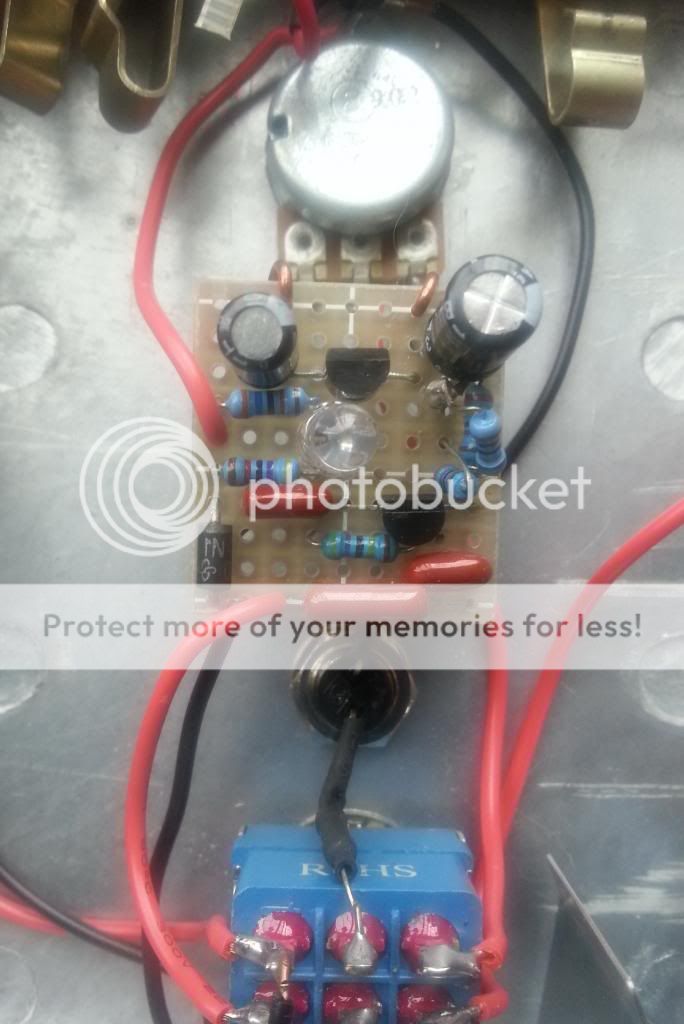

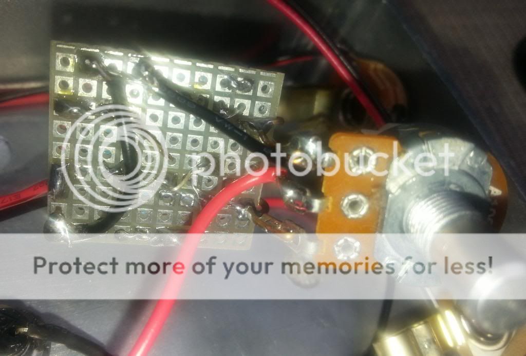

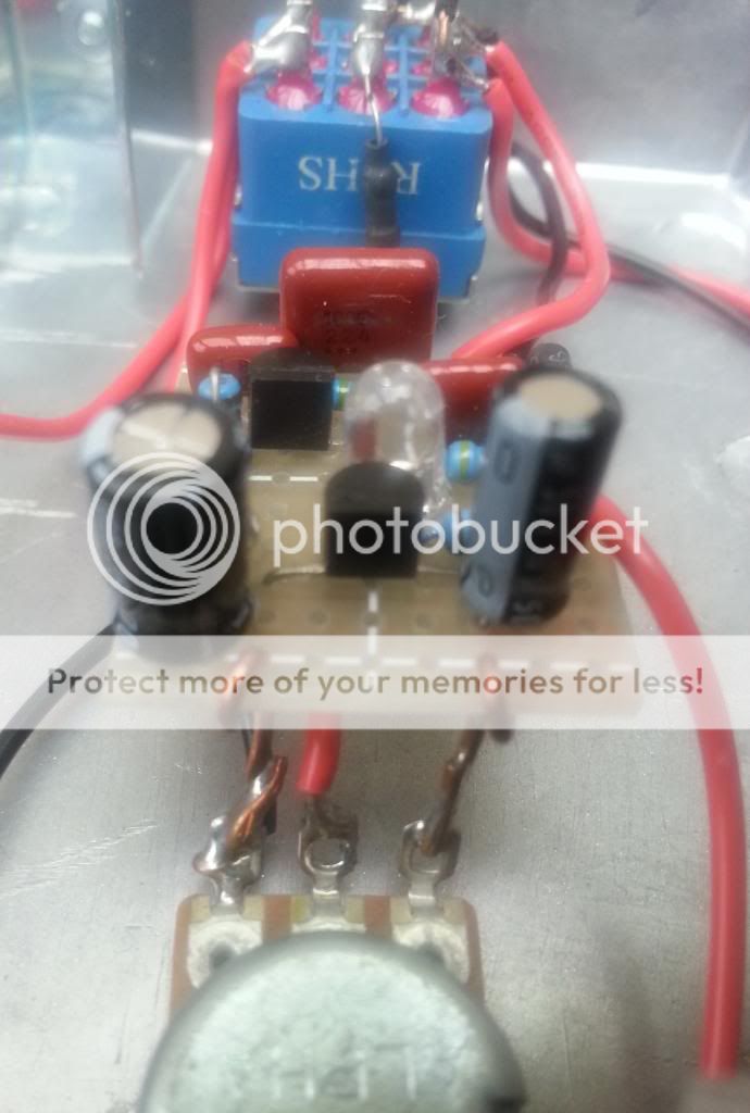

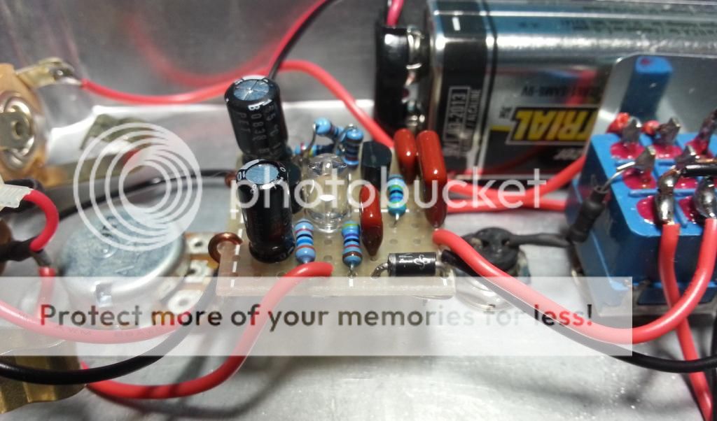

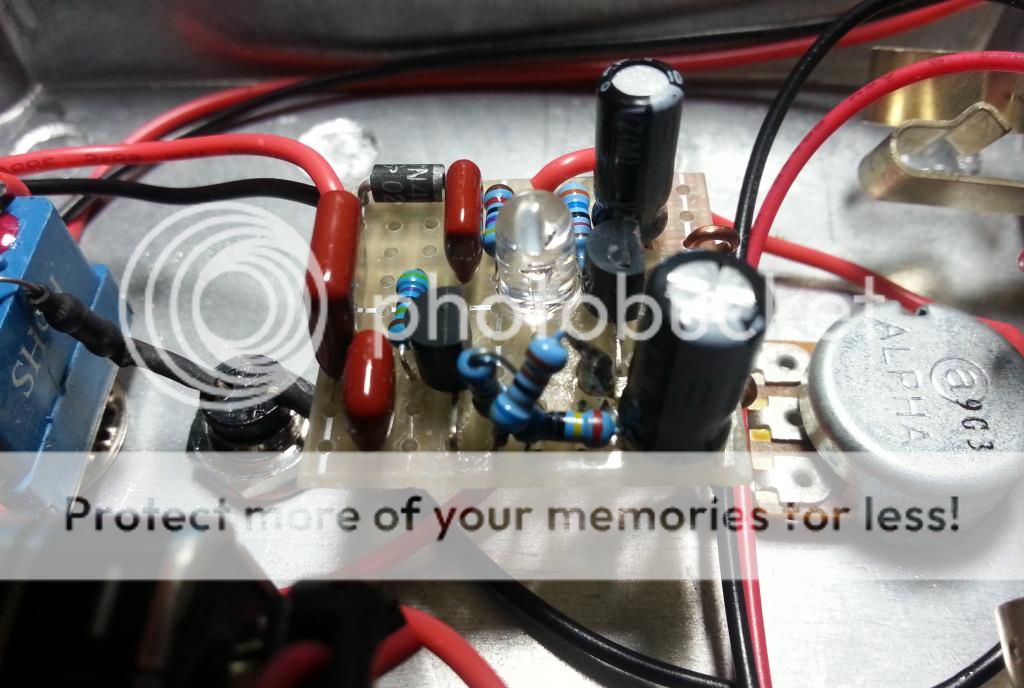

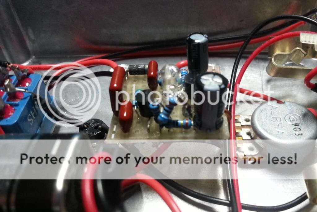

i had one but the price was high for such a small simple circuit. very mesy perf build. i have pics but I couldn't trace it. sanded tranny's
Would Like a vero layout or even a schematic if anybody has time or has one.
Thanks for anyone's help

What are the transistor, pot and cap values?

Sorry should put this in first post.
Transistors were sanded.
Electrolitics were 100 uf and 10 uf
caps are a .01, .0047, and .22
I forgot to see what the pot value was.

The pot is 100K log

Gracias. Pot is actually show in one of the pics, I just missed it. Can you post a close up of that mess of resistors on top and a shot of the bottom with as many wires out of the way as possible and no flash? First stage is pretty much a Bazz Fuss with an LED, but I can't see a few things going on after that.

all i have are here. Not sure if they will help.
