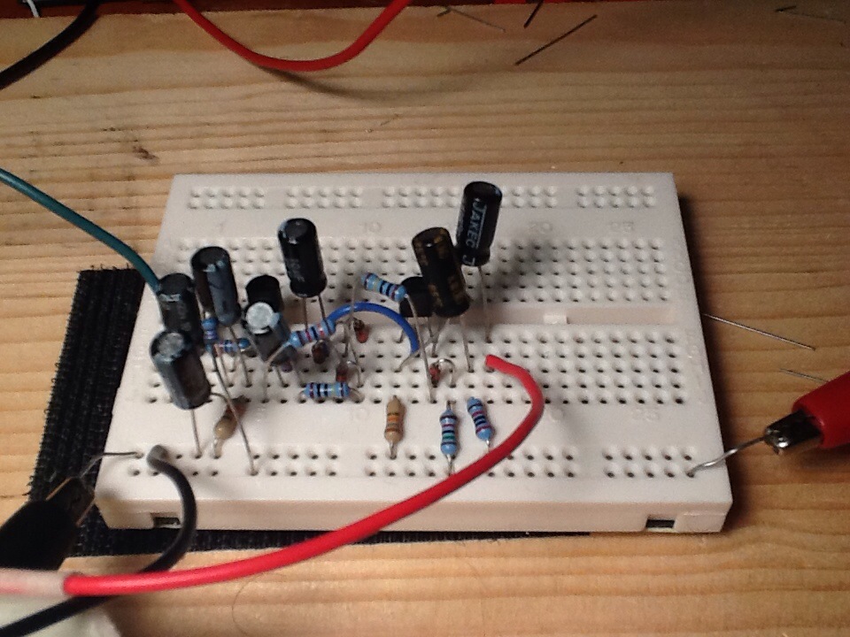

V_____ wrote:
mmolteratx wrote:
soggybag wrote:I think c3 goes to ground.
No, I traced that part, it doesn't go to ground. It should, but it also really shouldn't matter all that much since it blocks DC. Any steady reference should behave the same. I suspect it may have been easier to route it there on the board than to ground.
EDIT: V, I meant R10 should go directly to ground, and the only the positive end of the cap should connect to R10. Haven't actually traced that part yet, but if that's how it is in the actual pedal, it really doesn't make any sense.
You're right. I realized I made a boner a minute ago. That section seems to go like this.
[ Image ]
I breadboarded this up to C7. From C7 it doesn't sound like anything special. Splatty/gated with a hint of octave. The first stage sounded okay by itself. More overdrive than fuzz, with a little octave.
The TL-018-R change is good news, I think I have one if these in the parts bin.
