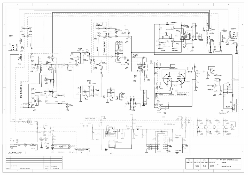

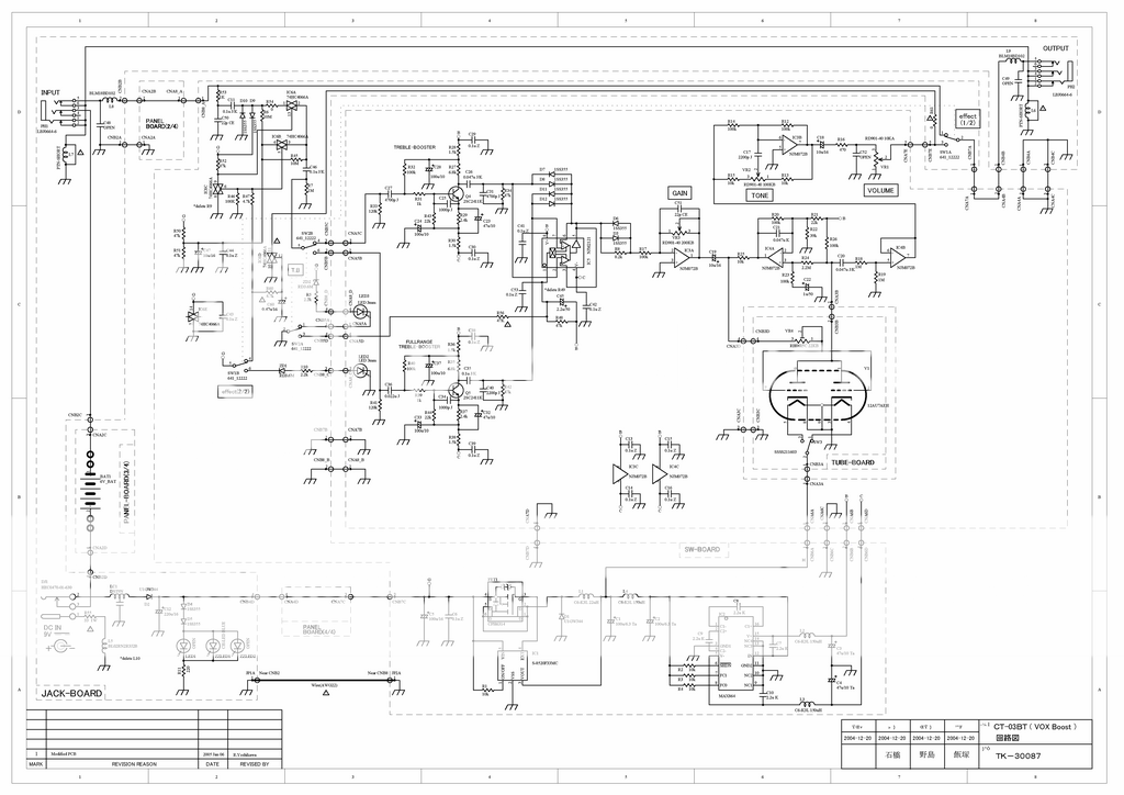

SORRY guys - Mr Mieda of Korg Japan may have patented a very interesting tube application - running off low volts - signal applied at the plate and taken out at the grid etc. ( I have built - and it is very very very sensitive to a slight change in volts to get it to work - more later!!)
BUT .....wait for it.... it is NOT the circuit element in the VOX cooltron pedals - I know, because I have the factory schematics for three of them!!!! They are just tubesreamer type circuits with a standard valve configuration after the distortion stage ,running off low heater volts

These crawled into my hands - honest
https://i197.photobucket.com/albums/aa2 ... age_03.png
https://i197.photobucket.com/albums/aa2 ... age_07.png
https://i197.photobucket.com/albums/aa2 ... age_11.png
enjoy

thanks bajaman!
one of these days, i should ask you what it takes to have hands which act as schematic magnets...
the vox catalog and flyers says so much blurb about these tube pedal series... once again, a huge marketing bull$#!t was shattered here.

Thanks !!!
Hey cool, there is real good electronic inside for the money - not like an SHO or other Zvex-es.....
But "tubescreamer-like" is a little bit unprecise cause the diodes in the feedback loop are in an inverting configuration which causes a different clipping than in a non inverting configuration.
But one question:
Why do you save a schematic in true-color ?
The first schematic (maybe even downscaled) needs 377k !!!
If you would use the freeware XnView and convert the scan to 16 grey-values it takes only 77kb, so with the same file-size you can get the double resolution. With this even the compponent values could be read.

The Cooltron pedals use a lot parts that were custom made for Korg, esp. for the tube circuit.
I have seen the partlist for the pedals and to me the only thing maybe worth for a DIY-build is the treble booster (known as Brian May T-Boost) in the Big Ben OD.

Hi Guilherme and others
I tried it and agree with Guilherme's findings - one millivolt either way and you are out of the ballpark
I did try it with a booster in front and it does sound nice, but clearly more work developing the idea is necessary - it does run very cold too.
