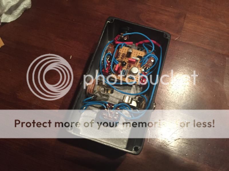

Found this picture online and decided to figure out what it was. The two 560k resistors were a dead giveaway that it was Bosstone based, so I figured I'd fill in the blanks. Not sure if this is 100% accurate (and I'd hazard a guess that it isn't since I don't know what the value of the Epcos cap and that little MLC cap are), but I built it up and it sounded pretty close to the sound in the demo videos I watched. I omitted switching and the boost function (just switches between two volume controls) on the schematic.
My build (I also included an input cap switch and omitted the 18nF option at the output):

Does the Boost knob and switch just trace out to being an alternate volume control? That's showing up a bunch lately, like the lead switch in the Tym J Mascis fuzz.

B3ar wrote:Does the Boost knob and switch just trace out to being an alternate volume control? That's showing up a bunch lately, like the lead switch in the Tym J Mascis fuzz.
Yep. It's another 100kB pot in parallel with the normal one. I guess if you wanted to omit it and have the exact same response, you could use a 50kB volume pot. Sounds just fine with 100k though.

Layout was actually perf with a PC mount WTF pot. Don't have it drawn up, though I guess I can trace it out if I have time. Might as well design one from the ground up though.

Nice job. Though not exactly as I do it. Go with a moderate 5088 and a T0-18 2907 for the tranny's.
You might find that .001 and .0022 make nice light presence cuts without throwing a blanket over it.
Yep. The boost is just my $1.50 boost. Nothing but a second Vol pot.
2k is a good minimum default for the sag. Anything less is pretty stiff.

I do have specific numbers I love for each tranny. It's a balance of dynamics, saturation and noise floor as Q2 is not just a buffer.
I use a BC183 in Q1 for some builds and Q2 is adjusted accordingly.
I would socket it up and find your sweet spot with your amp. My Classic 30 clean channel and my Hiwatt require completely different
tranny sets for best performance.
