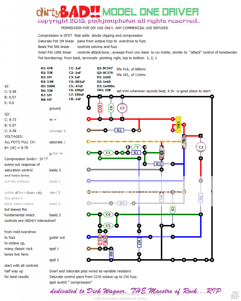

hey kids,
miss me? lol.... life's been happening..... bought a house, moved, been gigging like a madman, good things, bad things (dealt with a small tumor blocking my colon)... and here i am back at the diy thing. why?
well.. when going in for the damn colonoscopy that found the thing in me, while i was out, somewhow my right thumb got dislocated. now, i realize, some thumbs up my ass jokes have to be made, hell, i've made 'em myself, but no idea how the @#$% my right thumb could get this messed up getting a goddamn pipe stuffed up my arse.
well... anyways... between that and all the rest, i've kinda gotta take a break from performing so i started tinkering around a bit. fixing old f'ups and re-voiceing fuzzes, and fixing the stuff that BUGGED me about the crap i had left that wasn't sold or given away .... somewhere around 300 pedals have been made here, i have about 50 of 'em here still... that's a lot of sh*t STILL, but jesus...
one of the pedals i was dicking with was the third pedal i had started working up for wags, tentatively called the WWP... for Wagner Winston (my son, who was working with me on the design) and photon, of course. i had worked up the prototype and given one to wags when he visited in 2013, but frankly neither he nor i nor winston much cared for it, it needed more development. but with the move, and having my stuff in boxes, and all the other crap, it got waysided, and never got finished before dickie left us this past spring for the other side of that rainbow bridge.
well, late last nite, i took it to task... it was a pretty smelly fuzzface variant with a cheezy ass tone control for all intents and purposes. so i set out to try and maximize what i'd come up with, and ended up changing some of the things and adding some others, and using a few tricks i've learned from dickin' around with god knows how many circuits in various effects and amps.
when all was said and done, it's a three knob dirt box with one extra switch.
the first knob, "saturation" is not only a fuzz gain/contour control, but you can sweep it from octave up--CCW (WITH fundamental intact) to mild overdrive to fuzz at full CW rotation.
the baalz pot too sweeps , adds fuzz as well and acts as a master volume of sorts. i did NOT add a master volume, tho some peeps may want one. if so, standard 100k from the output should do the trick
the snarl control is a tone control, for all intents... it loses volume a little at CCW at some settings, and acts pretty much like an "attack" control on a tonebender... adds high end bite and fuzz the more ya turn it up.
the compression switch adds a diode clipper to ground from the output cap(s, i used two in parallel cuz it sounded great, no idea what the hell the capacitance would be.... 470n divided by 100n?? huh????) and makes it a little easier to get the octave thing happening.
all the controls are highly interactive, and it should let ya get well enough above unity gain to push an amp hard if necessary as a TRUE overdriver.
there are feedback loops all over the fuggin place, and things panning between different parts of the circuit. it was breadboarded up, and is physically built at this point... i dont totally understand all the things it does, but it's way different from what i've presented in the past.
this is a commercial product, for all intents, so DIY all ya want, but ZERO commercial use will be tolerated.
i'm sure i've reinvented the wheel, and someone smarter than me (easy, these days) i am sure can tell me what i've lummoxed across as a circuit, as these things NEVER end up being "original" (other than maybe some phat pink schmuck using a ge fuzz in the feedback loop of a jfet opamp as a clipper....AHEM).... so please feel free to educate my dumb ass. i'm sure Gus has already done this. ;) but i hope not... of course..
really nice dirt box, capable of a LOT of tones. cleans up fairly well from the guitar, too. nice sustain, not a lot of background noise...
another PJP hybrid circuit, npn, so it plays nice with other pedals.... bc547 for q1, and ac176 for q2. hfe's, e/b/c voltages on the graphic.
made a cheezy pcb pattern as a schematic... still no idea how the hell to do a schem other than drawing it out by hand. i did. will scan and post that tomorrow maybe if anyone is interested or can't follow this graphic.
no vero yet... i use perf more these days... go figure...
would LOVE IT if some crazy person wanted to throw this on the breadboard and see if they get similar results...
btw... q2 can be damn near anything i think... socket and experiment. i tried several GE's in there, cuz i roll like that, but 3904's or whatever will probably work too.
enough of my yammering bullsh*t ;)

Can I ask what the Snarl pot does? It doesn't appear to be connected to anything, it's just hanging off the emitter.

made a mistake, forgot a cap...
here's it again, and right
here's the layout with the cap added back in. note: acts COMPLETELY different when the comp switch is off and on.
EVERYTHING is interactive.
if the snarl control works backwards... it may... simply reverse the connections to pins one and three.
also... duh, dumb dumb dumb.... snarl pot is 50k, not 100. my bad. don't know why i thought it was 100, didn't notice til i stuck it in a box.
sorry for any confusion ;)
this thing sounds kinda like a synth with the snarl and saturation all the way down...
would love to see a brave soul try to breadboard this and see what ya think...
thanks for the welcome back ;)

shit, more mistakes and a couple notes... first,
the CORRECTED schematic of what i built:
and the corrected layout, repeated, just for chronic ocd's sake:
ok. THIS shit above is what i built.
that said, it can be simplified. the snarl pot works out to about 3.6k when ya do the math between the 50k pot and 3.9k resistor... so i imagine ya could use a 5k pot and drop that one resistor.
also, the .470u and .001 cap adds up to a whole FOURHUNDREDSEVENTY ONE nanofarad... pretty damn close to 470. so i would imagine, that one cap (.001u) could be removed, too... but ... its total mojo, ya know... magic, never believe it's not so...
this was all from hacking on a pre-existing circuit, so hence the weirdnesses. that said, exactly as built, this thing is fuckin cool... almost like a string/brass synth when the saturate and snarl pots are all the way down.

I've just breadboarded your latest creation (using a 10k pot and no resistor for the "snarl" and connecting lug 1 to ground as you surely intended) and omitting the "mojo" capacitor. I used an unmarked Russian Ge device for Q2 and a BC107 (lots of metal-can mojo) for Q1. I added a 47k output pot - I got quite a big boost from the thing. I prefer it without the diodes connected (and the huge volume loss you get with them switched in), but I tried adding a pair of LEDs in series with the 1N60s. You still get the rounded edges from the 1N60s, but with bigger amplitude. Now that sounds better! I found that the "saturate" control was causing instability towards maximum resistance, but that could be fun if you want it to squeal! I set the bias at just under 5V - that's where it sounded best to me.
This one's going to get boxed up, I think......

mictester wrote:Hi Jimi
Good to see you here again. Terrible news about the tumour, but great that it got fixed.
hi chris,
nice to hear from ya! thanks for building this...
yes, it IS loud... i don't use the pots all the way up, so i didn't need the volume control... i thought it sounded fuzzier with the sat control up, and the baalz lower. but if ya crank all three, i can see a need for the master volume. ;)
actually, the snarl pot is different.. i didn't connect pin 1 to ground, cuz it's using it as a rheostat instead of a potentiometer... the snarl control if it goes to ground will sound different (i did try it that way)... i THIMK the thing works by changing the ESR of the pot.
i agree on the diodes... big volume drop, but easily compensated for... and at some settings quite cool i thought.
the saturate pot at max resistance (full ccw) with the snarl control also full resistance (ccw) it's REAL close to instable for sure! on mine, it has a notch you can sweeep thru as ya mess with the bias some... but all the way ccw on sat and snarl (as i drew it) i get this cool octave up WITH fundamental, and it gets very synthy sounding... somewhere between strings and woodwind kinda sounds.
i was mimicking violins and cellos with it, last nite i used it live and got a passable enough flute sound that my drummer thought someone in the audience was playing the flute on "locomotive breath"... very cool.
do me a favor bro... try disconnecting the ground from pin 1 of the snarl control, and try it as the rheostat rather than bleeding stuff to ground. you can always put it back if ya like, obviously. ;) i wanna see if what i built is repeatable for someone else.
for all intents, all it is is a passive guitar style (almost) tone control.
i like the led trick... i tried it too, but liked it better with the ge. i too prefer them disconnected for most things, BUT they work as a simple compressor when on....they let ya sweep the saturate control without getting a massive volume increase from ccw to cw (full resistance to minimal resistance)... when off, it gets LOUD when ya crank the sat control. they also sound good on when the sat and snarl are fully ccw... helps keep the volume more consistent.
i like the idea of adding the leds tho WITH the ge.. you get a nice tone that way, i did that on a different circuit recently.
try it if it'sm still on the breadboard as shown minus the mods you made.... at half way up it should sound like a decent marshall-esque kinda overdrive. from there, you should be able to tune in all kindsa stuff. adding a master as you did will let ya crank it more and then dial it back... i just didn't wanna put a 4th pot on it. ;)
that said, i found a 10k-ish pot between diodes and ground with a switch between was also kinda valid... you could mess with the amount of compression that way.
you should be able to get fuzz, overdrive, multi octave (fundamental and oct up) kinda sounds fairly easily.
of course, the number of vegamatic switch functions is entirely up to the builder ;)
as you can see, no connection to lug 1 of the snarl pot^^

yeah, it doesn't do the cello thing the same with the snarl pot grounded. but it still WORKS when it's grounded.
so beats me.
i checked it out again, to be positive, and yes, that stoner control snarl pot is wired as i said... it's a jumper right off where the baalz pot is connected to the circuit board.
i DID, just now, add a master volume control. chris said he used a 47k, but i found a 50k or 100k pot seemed to change the interaction of the controls a bit... you couldn't just dime it the way ya can without it. so i used a bog standard 1meg linear tayda dealio, totally standard thing between the output of the board and the switch. can dial in some more fuzz and overdrive sounds that way too, and tame it a little. and half way up it sounds pretty good and is close enough for unity gain for rocknroll.
if ya really want fun, stick a three knob ge tonebender in front of it. holy sheet.... i just got lost for a couple hours playing with it. thick and phat as hell, and ya can still get the interaction with the fuzz in front.. except it doesn't get clean and glassy, just turns down and stays crunchy and phat, but quieter. hell, i may build something with a toneblaster (my formerly sucky si/ge tonebender variant, also recently updated) and this as one circuit... is seven knobs too many?
also, ya may wanna consider using the "mojo cap" as hard wired, and switching the 470n cap in in parallel with a switch so ya can have a "slim or phat" control, kinda like using the input dealio of the os mutantes regulus on the arse end instead. in that case, i'd probably go with a bigger cap there, maybe 4.7n to 10n or so.
as always, don't get too hung on the transistors.. i'd advise socket and experiment. i DID try a darlington in q1 with some amusing results, and several ge's, different variants of ac176 and and even some silicon with some decent results. the gain matters most most likely, as the ge and si's of similar gains sounded a lot alike. neither was really edgy as i'd expected.. this thing is creamy smooth. with a touch of snarl.
anyways, that's my story, and i'm sticking to it. ;)

please check this here linky out
https://www.diystompboxes.com/smfforum/ ... msg1004723
here i let the magick smoke out...
mystery solved of the snarl control... i likes my crow with ketchup please
ok.... correct wiring....
pin 3 of snarl pot to circuit
pin 2 of snarl pot to 3.9k resistor to 100n cap to ground
pin 1 unconnected for synthy sounds, or connected to ground for more fuzzular thickness, but less dynamics on the string/woodwind/brass sounds.
i decided, fwiw, to NOT connect pin one. connected its still good, but there's definitely a bit of difference between the two. please try both, see what you prefer.
it may be worth adding a switch.
again, sorry for the confusion. but i hope my insane mojo imaginings were entertaining. i gota get this laudanum belladonna tincture dialed in a little bit.
here ya go, WITH added synth/fuzz switch.
i thiMk it's right finally after a horrid birth process.

thanks for the layout, jimi. it's always good to see your work.
feedback loops are dirty tricks. the more the merrier. i hope to be getting into full-on breadboarding properly this year (have only tinkered with peripherals to date), so will keep this design in mind for a reckless moment.
re your ups and downs... am glad to hear you are back in the pink and that the force is still with you.
re tincture... remember, teaspoon for laudanum, table spoon for chocolate pudding. no improvising.

That thing sounds sick! I'll have to add it to my ever-growing list of circuits to build. Here's a perf and PCB layout if anyone's interested.
Hope your thumb is on the mend!

Been following this thread since I came across it, might have a go at breadboarding this circuit up so I can go through it with my Signal Generator and Oscilloscope, I think that Snarl pot is acting like some kind of filter but I won't have a clear idea till I do the breadboarding, my computer went down on Tuesday this week so I had to do some work on it to get it working again, won't go into it too much, but it looks like it's all sorted now..... :thumbsup
@ pinkjimiphoton, good to see you're alright mate..... :thumbsup

storyboardist wrote:That thing sounds sick! I'll have to add it to my ever-growing list of circuits to build. Here's a perf and PCB layout if anyone's interested.
[ Image ]
that's beautiful!!! i will build the perf today maybe to verify it, i gotta work up a vero too one of these days.
my thumb is a LOT better... it was amazing being able to play with a pick again last nite. i had to turn off my shredder switch! ;)
went to the doc, he was like... three opptions asshole (he swears as bad as me)..
mega doeses of antiinflamatorys and a brace..
tried it . fail'd.
shot of cortisone.... i say yes please
or go see a hand specialist, cuz you're a fuckin musician, so a normal doc doesn't fly.
i said shot?
hurt like a bitch... i was whininglike a little girl.. half way thru the shot, the pain went away
he goes "if i got this right,"
and i say the pain is GONE!!
he goes, "i'm a fuckin' miracle worker, ain't i?"
i, without thinking about it, went to give a thumbs up.. my thumb went POP! poPPP!!! real hard, and suddenly went back in joint again i couldn't even move it before that.
thanks for the groovy layouts!!! i hope you dig the fuzz when ya build it!

DrNomis wrote:Been following this thread since I came across it, might have a go at breadboarding this circuit up so I can go through it with my Signal Generator and Oscilloscope, I think that Snarl pot is acting like some kind of filter but I won't have a clear idea till I do the breadboarding, my computer went down on Tuesday this week so I had to do some work on it to get it working again, won't go into it too much, but it looks like it's all sorted now..... :thumbsup
thanks simon, glad to see ya here still!!!
and thank you for the well-wishes. :hug:
i hope your puter is a-ok. you GOTTA at least breadboard one of these things bro.
don't worry about the transistors too much, pretty much anything will fly in it. may need to play with the biasing a little is all. :whappen:

here's a preliminary vero. unverified. maybe build it tonite....
seems good to me, but i'm the king of f'n up ;)
