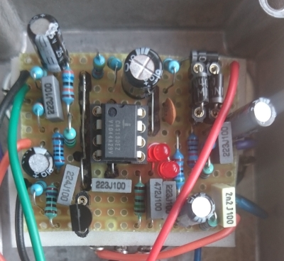

This is a schematic of the degooped BJFE BOD #045
I am the owner of this pedal. The switch became faulty recently, so I decided to replace it and trace the schematic while it was open. Here are some pics of the pedal:
This schematic is different than the Mad Professor incarnation in a few very important ways:
  • 1. The MP has a JFET amplifier in the beginning, the BJFE does not
    2. The MP gain pot is 1M, the BJFE is 370k
    3. The MP tone control effects the AC gain of the output JFET. The BJFE tone control effects the output treble response
As a result, these two pedals do not sound the same.
Some people have reported their blueberry uses a LM301 IC. I have breadboarded this circuit and can attest that the CA3130EZ sounds much better. The sound is more clear and articulate.
The gain pot is an unusual value of 370K. I made certain this value is correct. When I breadboarded the circuit, I tried a 250K and a 500K. I noticed the 250K sounded identical to the BJFE, whereas the 500K increased in gain too quickly, and became muddy. This may partially explain why the MP version sounds so different. If you truly want to emulate the 370K pot (I couldn't find this actual value pot anywhere), you can use a 2M pot (smallbear) in parallel with a 470K resistor. The upper range of the gain pot does not give much of a difference in sound, and the 250K is just fine IMO.
Although the output volume pot is linear, it helps fine tune the level when adjusting the gain. An audio pot is usually a standard, but a linear has proven useful for me when I use basses with different output.
I believe that R11 and C8 are easter eggs...meaning, they produce no effect and exist only to make tracing this circuit more difficult. Removing them seems to have no effect on the sound. R9 and C7 definitely have an effect...reducing gain and high end. This may be 50% of why this circuit sounds so unique.
I have made a layout based off of madbean's Yellow Shark, since they are similar in design. I left R11 and C8 for the purists. I did not include the zener diode for the LED (use a bigger resistor). I tied lugs 2 and 3 of the gain pot together if you choose to use a wire on lug 3.

johnk wrote:just wondering. are you sure that the 2n2 on the tone circuit connects to lug 3 of the volume pot as opposed to the Jet's source as BJFE does on all of his other OD's?
I noticed that the madbean Yellow Shark (BJFE honeybee), the Bearfoot and the Mad Professor 3BOD's have that cap connected to the source.
I am 100% sure the 2n2 is connected to lug 3 of the volume pot. I noticed this difference right away and made certain I had it right.

awesome. thanks so much for this one. myself and a few other bassplayers have worked on the bearfoot version, and i have been dying for the original for a long time to say the least. i've actually gave up hope that this would ever come to be. i'm going to get to work on a vero layout for this, and i'll have it done some time tomorrow. really man, i can't say thanks enough. :thumbsup
yeraym
Posts: 4
Joined: 16 Dec 2012, 15:31
Been thanked: 5 times
Post by yeraym »
Thanks again, I drew my own vero and finished it yesterday, this sounds incredible with my bass.

Thank you so much for posting this !
I just built it in a 125B with top jacks. It really sounds great. I used the original schematic you posted, i.e. with the zener diode and etched my pcb after having made my layout in Eagle (not so different from yours that is).
Here are some pictures and the files I used, for those interested in etching.

Hello everyone, a new poster and beginner pedal builder here!
I built BBOD yesterday using Yeraym´s vero layout and it sounds absolutely wonderful! However, it is not very loud: when I have both gain and volume maxxed out, the volume level is about the same as in bypass mode. And consequently, if I turn the gain down to get mild crunch, the volume level is considerably quieter than the clean signal. Is this normal behaviour for this pedal or have I screwed up somewhere? How should I go about mending this?

Coolhat wrote:Hello everyone, a new poster and beginner pedal builder here!
Hi well you can try to connect a 1uF cap in series with 4K7 across 2K6 written as R14 in schematic in this thread and you'll get about 6dB boost
Hi
Make sure there's no mistakes. I tried a 10 µF cap at the FET source resistor. More gain, but didn't like it. It perhaps alters the feedback to "Nature" pot in a bad way. To me the circuit has enough gain.
I have a Bearfoot unit and I modded it to the original BJFe (That schematic above). To me it sounds better.
Only little change to the BJFe circuit is to lower the minimum IC gain. It's now a hair over 1, and the sound is practically clean at 0 ( with a P-bass).
It is really nice, natural sounding unit. Best I've have had. It is so good it doesn't need a blend as usual. I even sold my Tech21 pedals.
