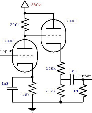

extreme distortion with two triodes
- Posts: 23
- Joined: 26 Jan 2009, 18:13
hi,i have this thing in my mind ,why is not posible or maybe posible to obtain maximun distortion with only two triodes ,like a fuzz face or zonk machine,am a electronic tech but no experience in design .i ve seen a 100 schematics of valves preamps ,and all look the same ,only the ones with more valves sound good,or the ones with a solid state drive sound good(am a death metal lover,the scoop sound).i hope that someone has and idea of how to do the design or suggestion(i was thinking of a valve schmitt trigger).

If you like severe distortion tones, try to build a clone of this: https://www.freestompboxes.org/viewtopic ... s&#p180066
The couple of silicon diodes are BAT41. I discover this after to publish the schematic.

If you set up a 12AX7 so that you have two Triode gain-stages cascaded, with careful biasing you can get the circuit to clip similarly to a Fuzz Face, connecting the two Triode sections up the same way as in a Fuzz Face is not going to work simply because a Triode works differently to a Bipolar Transistor, firstly a Triode is a Voltage Amplifier and a Bipolar Transistor is a Current Amplifier, that is to say a Triode is controlled by applying a Negative Voltage to the control grid to reduce the flow of electrons from the cathode to the anode, without the Negative Voltage on the control grid the Triode fully conducts, on the other hand to get the electrons to flow from the Emitter to the Collector you need to Bias the Transistor so that it conducts and this is done by applying a small current to the base of the Transistor, basically the opposite to a Triode....
I have actually tried connecting a 12AX7 up in a Fuzz Face circuit and know from experience that it doesn't work....

I think the OP was wondering why two "stages" of a Fuzz Face obtain so much distortion compared to two tube stages.
I've built a lot of different types of amps and you can get quite a bit of distortion from just two 12AX7's.

Something like a Fuzz Face will give the impression of more distortion because there is nothing to really attenuate the treble frequencies.drewl wrote:I think the OP was wondering why two "stages" of a Fuzz Face obtain so much distortion compared to two tube stages.
A triode like a 12AX7 has ~150pF capacitance at its input. When an amp design has grid resistance, this forms a lowpass filter.
And that is only one source of a lowpass filter in the typical tube preamp circuit - there is usually more attenuation to keep unpleasing treble frequencies in check.
So to approximate the non-treble-attenuated aspects of a Fuzz Face, a tube preamp would need treble enhancing circuitry, primarily in the form of highpass filters. Along with those, the stages could be cold biased to also increase the emphasis of clipping in the treble ranges.
Again - amps like Marshalls tend to have the treble-peaking circuits that consist of a 500pF/470k pairing. The issue becomes that the 470k into a triode's grid creates a lowpass filter that removes trebles above 2k2 Hz. So you really don't want to go with a grid resistor that is much larger than 200k - this will give you full-range up to about 5k3 Hz. Obviously 180k or smaller will ensure that nothing in the audible range is removed.
The second gain stage in many Trainwreck amps would typically have a 2n2 decoupling cap that was simply followed by either a 56k or something like a 150k resistor shunted to ground. That would yield a highpass filter of 500 Hz to 1k3 Hz. There was NO grid resistor into the third stage. Then the third stage was cold biased with a 10k cathode resistor.
So - to get the impression of the same overall amount of distortion as a Fuzz Face, the triode stages simply need to be configured as described above, which is probably the opposite of what you'll find used in guitar amplifier preamps, especially ones tailored for large amounts of distortion. The Soldano link was provided, and it makes it very clear what was done to heavily attenuate both the bass and treble content at the stages that actually are capable of clipping.
The truth be told, something like a Big Muff is probably more similar to a high-gain guitar preamplifier than one might realize. The three gain stages all will typically have trebles above 700 Hz rolled off. That is an extremely low frequency for a lowpass filter. The two stages that actually employ diode clipping then also have their frequency bands tailored to narrow the range of what is clipped. The Fuzz Face is absent of these design elements altogether. And comparatively-speaking, so is the typical high-gain tube/valve guitar preamplifier.
