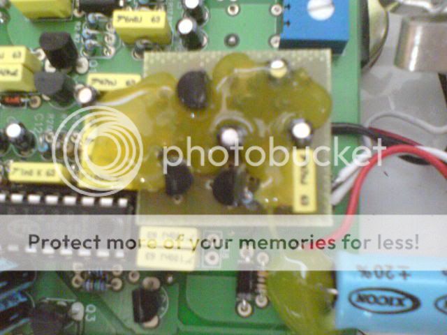

Brian ...whats that yellow stuff ..... :hmmm:

yellow mojo slimer!!!! without it it won't sound so good!

:hmmm:
could it be yellow mojo covering that noise reduction circuit Brian is talking about?
:secret: a 3 transistor noise gate you can find the schem around....
Skreddy
Posts: 419
Joined: 11 Nov 2007, 04:22
Been thanked: 228 times
Post by Skreddy »
Looks like he's using some hot glue or similar substance to provide mechanical relief/stability.

Post by MoreCowbell »
Looks like hot glue / epoxy so that the mini "sub-board" doesn't flop around in the box.

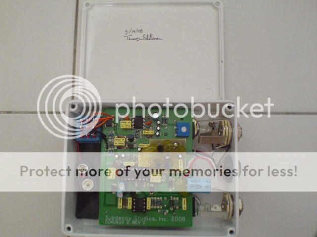

Post by Brian M »
We ordered in some new boards, and have cleaned up the messyness. I decided to pull an A/DA after i built the first one. I wasn't happy with the results, and decided go back to an earlier version with a discrete noisegate. Unfortunately we already had a bunch promised to our dealers, and we were already a few weeks behind for delivery. I drew up a new board and ordered them in as quickly as i could. I also had the new boards made with a white mask so if there are ever any questions about them I can simply ask what color the board is. Many of the resistors were mounted vertically on the first board as well, which I found to be problematic, since the 1/8 watt resistors are hard enough to read anyways... mounting them flush on the board makes finding potential mistkes much easier to find.
Anways, someone mentioned a 3 transistor noise gate, which is exactly what is going on on the sub board... although it wasn't really something i got off the internet.... although the tools are very basic, and stuff anyone familiar with pedals would easilly be able to understand. Essentially it's a mosfet booster, followed by a halfwave rectifier creating a DC voltage... a jfet set up similar to a boss/dod bypass switch system, and then a mosfet or jfet amplifier out to the delay level control. only a few had the mosfet output.
Anyways, normally I make a point not to cover up my work, It is hot glue, which i chose over epoxy because it's much easier to remove should any repairs ever be needed.
We actully use hot glue on the quasar volume control mod boards as well, although those ones look a bit nicer, and the glue is under the board, not over it.
The stupid box also uses it around a couple of the capcitors, because a lot of people seem to step on that pedal with the back cover off so they can access the trim pots easilly... every now and then we get one where one of the caps takes too much pressure, and the solder joints don't hold up.

Post by Brian M »
seniorLoco wrote:ahhh it's all good Brian :D
now tell us a bid more on the device !!
Well, it's a pt2399 based digital delay. I'm sure most of us have seen one in action, so I'll spare you the details on the delay line.
As already mentioned it has a noise gate circuit at the end of the delay line, which is especially useful with the natural decay feature.
Frequency emphasis and deemphasis is used before and after the delay line similar to many analog delays.
The LFO uses a TLC2262, which runs off the 5V regulator which also powers the pt2399. The advantage of this, is that there wont be a shifting voltage offset as the battery weakens. The LFO wave is filtered quite a bit so it doesnt sound too "triangley"
When in natural decay mode it uses fet switching similar to a boss pedal. when natural decay is off, it runs in true bypass.
I built a bunch of different prototypes, many with different features, over the last year and a half or so. A couple were even BBD based.
The main inspiration for this pedal was the PT80. Not that I blatantly copied anything... in fact it's quite different... but I built a PT80 a few years ago, which I've always been fond of. My other two favorite delay pedals the maxon AD9 and boss DD3 guided me a bit, as far as voicing goes. I wanted it to be somewhere between the two.
