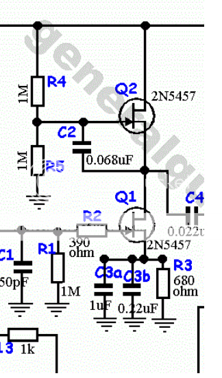

I have few questions about tailoring mu amp gain stages:
- I wanted a mu amp gain stage that will boost signal frequencies over 600hz. What capacitor values (C2 and C3) should I use on schematic shown on the next picture?
- Some mu amp designs don't have R3 and this does. Does it mean that jumper instead od R3 would give maximum gain and resistor lower value? Can this gain be calculated?
BTW Thank you all for your patience and knowledge you passed, this means a lot to me and other beginners reading this forum.

Can anyone help me with this please?
changing that value does change the gain, and a lower value would give more gain. but that changes other factors as well, not just gain. and there are other ways to change the gain of the circuit without changing the value of the Source resistor. C3 is the Source bypass cap, which has the same effect of increasing the gain of AC signals, but unlike changing the value of R3, it does't affect any of the DC characteristics of the circuit. The reason for having different values for C3 is to shape which frequencies have what gain... it's a matter of the capacitor's relationship to R3... a larger capacitor will bypass lower frequencies - a sufficiently large one (like, say, 47uF) would extend the frequency response enough that it would be giving max gain at all frequencies, and as far as the AC signal is concerned, it would be like R3 were a short straight to ground. Using a smaller value for C3, like 100n, wouldn't be enough to bypass low frequencies, so only higher frequencies would have higher gain - this would give it a brighter sound. And you can put resistors in series with the bypass caps to control exactly how much gain you have in the circuit, and you can even have multiple caps with different resistor values in series with them to give it a even more precisely shaped response.
Sorry, I can't really help with the math...
Maybe you can find some good info here: http://people.seas.harvard.edu/~jones/e ... ure_4.html
and more generally here: http://people.seas.harvard.edu/~jones/es154/
This is probably a reliable source of info. :lol:

BIASING: isn`t it the SOURCE with the variable Voltage Divider(not the Gate)?????
You can use a variable Source resistor as a method of biasing, but you still run into the problem of potentially changing the gain and frequency response of the circuit. Using a variable voltage divider feeding a bias voltage via the Gate resistor allows you to adjust the bias without affecting the intended gain or frequency response.

Soulsonic, can you explain to us how to make a variable voltage divider that biases the JFET via the Gate resistor?
For example, if I use J201 for gain stage, 1k resistor between source and ground (usual value), 10k between drain and 9v how would I bias Jfet via gate resistor? would I use trimpot instead of 1M between gate and ground?
Like this.
Simple JFET biasing
Simple JFET biasing
And this basic topology can be used for numerous other transistor circuits.
