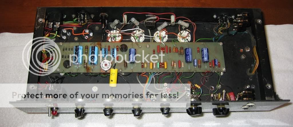

but I took some pictures before....

here goes-

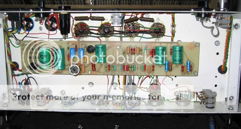

This one was looking like in the second picture.

inductor.... very cool...
here in chicago, i'm a live sound engineer, and these are always some of the best sounding big rock amps i hear. i've never heard someone screw up the sound of one, which can't be said for alot of other big name/high gain amps. i like the simplicity of them and the rotary switches. you think the inductor is for the presence circuit?

If it's like the Orange Graphic MKII (and I would definitely think so regarding the components, layout and placement of the parts) then the inductor is at the cathode of the third triode stage. Look here.
The preamp is completely different to an Orange, the inductor is used for the presence control.
