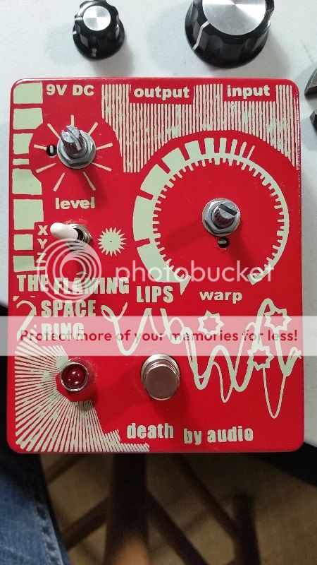

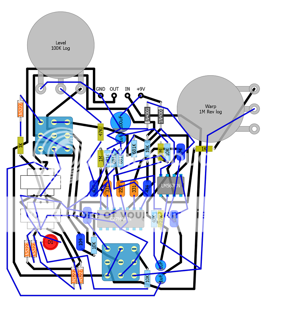

I have a few pictures and I traced out the PCB layout with DIYLC.
I'll try to make an actual schematic and vero in the next week or so, but I might get caught up with work, so no promises.
I checked some of the harder to notice connections with a Voltmeter, so I'm 95% sure that everything's correct. If not, maybe Glass Hero will point it out.
Black is the top trace, blue is the bottom.
In case anyone tries to trace it themselves to verify my layout or whatever, there's a hidden resistor underneath the Warp pot.

For some reason I didn't see the post at the very top of the screen and was starting to trace it out and noticed "hey what's that resistor under there".

That's cool software you used, I've never used it, but did you just lay down all the parts and connect the traces as you saw them on the pcb?

Lubdar wrote:That's cool software you used, I've never used it, but did you just lay down all the parts and connect the traces as you saw them on the pcb?
I actually traced out part of it with a multimeter, like the traces underneath the switches, IC's, and transformers. I'm not sure how accurate it is, but I'm not quite ready to start removing components yet.

Holy shit, I started trying to work on a schematic for this today and it is probably the most confusing circuit ever.
There's a million connections for a million different spots and I seriously wonder how the hell they ever managed to design it in the first place.
