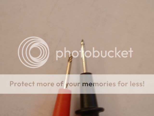

FINALLY, do not use your expensive Fluke multimeter set to ohms range for measuring high voltage in tube amps

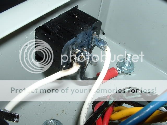

100% right here. I accidently leaned on the power plug while it was plugged in on my last amp buildbajaman wrote:another piece of advice - unplug the power cord from the mains supplybefore working on any mains equipment
I speak from experience (or lack of) here![]()
And also with the multimeter statement: Be careful measuring the outlet wall voltage while the multimeter is set for DC! I did this the same day as my power plug incedent and blew the power breaker in my garage and there was a huge spark. Heres some picture of what happened to the power plug and the multimeter probes!:
