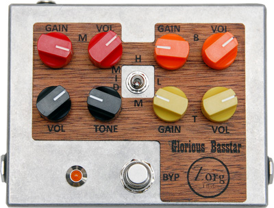

So as said in my presentation, I'm a little boutique pedal maker from France. As I did learn from DIY (but also engineering school), I wish to return my knowledge...
So here's one of my favourite creation, the glorious basstar is a 3 band overdrive. It's been designed for bass, but it works ok on guitar, I don't like it on guitar but you try and tell me!
The presentation on my website
(It'll be available in kit as soon as I get the batches of boards...)
Looks like that (On final version, volume and gain pots from mid band a reverse for ease of use):
The latest schematic :

Ok guys that's the board, with jumpers on:
Some important infos:
The board is 93mm x 64mm
Although this is not mandatory, I solder the switch and the pots directly on the PCB (So that it holds the board in the box), but I solder them on the other side than the ones with the components. This makes the soldering of the switch a bit shitty and you should absolutely test your solders before going any further. 100% of my problems on this board came from bad soldering of the switch...
