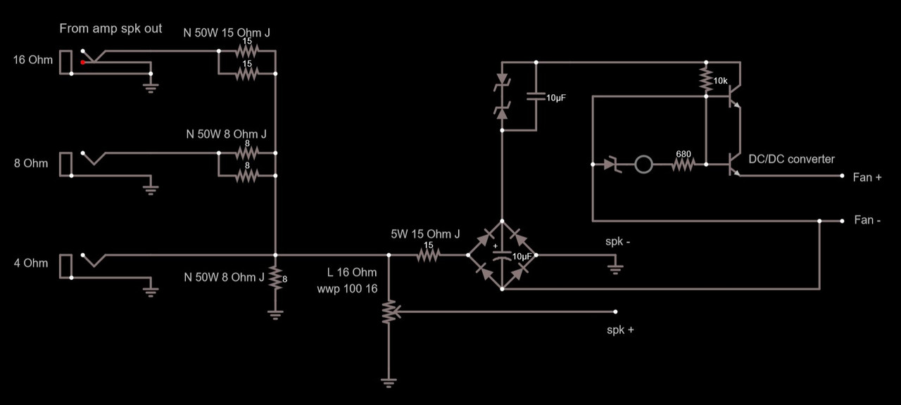

Here's what I traced when I got the unit which is slightly different from the schematic posted above. I didn't trace the line out or the mic out btw.

Maybe recheck your drawing of the HB Attenuator, my guess is that the NEG speaker output is also at Common/Ground to input, you can easy check with a meter to see if it is Common.
Also the 10uF on the Bridge Rect is upside down.
Regards the suspect resistance on 4 Ohm you may find that the switch in the plastic 16-Ohm socket is not making contact when the plug is removed, it's a common issue with those type of sockets.
BTW, the bridge (BR1) in the Marshall schematic is drawn wrong, rotate it 90' to left for correct orientation.

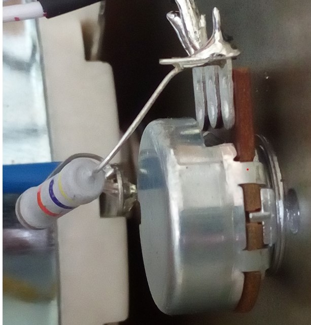

Just a contribution to state that I've got a PA100 with suspect readings apparently due to a botched inner wiring...
All was fine with the 4 Ohm and 8 Ohm inputs... but when I've tested the 16 Ohm input, DCR reading were very high and always changing.
There was a cold solder on this female jack plug.
Once this issue corrected, the 16 Ohm input worked but the other inputs exhibited high DCR readings: around 8 Ohm for the 4 Ohm input, around 12 Ohm for the 8 Ohm one.
So I've connected to ground the unused lug of the switching jack, on the 16 Ohm input... and it worked, since the DCR readings are now those expected from 4/8/16 Ohm impedance inputs.
Also: the line output didn't work. The resistor between rheostat and pot had a leg touching the housing of the pot...
I hope this explanation to be helpful for PA100 users: before to use it, check the inner wiring of this thing, people!

Thanks. Both correct.
I've added a corrected version of the schematic below.

Yes, I see how easily this can happen:
Your post made me open mine up again and do all the readings again.
I think I made some mistakes when I first did them (connecting the speaker cab to the inputs at the back of the attn instead of the output.)
Anyway, so this is what I read as far as DC-resistance goes:
Speakers by themselves:
4 Ohm speaker: 4,3 Ohm
8 Ohm speaker: 8,7 Ohm
16 Ohm speaker: 14,3 Ohm
Attenuator without a speaker attached:
4 Ohm input :
-with level knob at 5 o'clock (max position, minimum attenuation) : 5,4 Ohm
-with level knob at 7 o'clock (min position, maximum attenuation) : 4,5 Ohm
8 Ohm input :
-with level knob at 5 o'clock (max position, minimum attenuation) : 9,3 Ohm
-with level knob at 7 o'clock (min position, maximum attenuation) : 8,5 Ohm
16 Ohm input :
-with level knob at 5 o'clock (max position, minimum attenuation) : 0,5 Ohm
-with level knob at 7 o'clock (min position, maximum attenuation) : 0,5 Ohm
Attenuator with a speaker attached:
4 Ohm input :
-with level knob at 5 o'clock (max position, minimum attenuation) : 3,5 Ohm
-with level knob at 7 o'clock (min position, maximum attenuation) : 3 Ohm
8 Ohm input :
-with level knob at 5 o'clock (max position, minimum attenuation) : 8.7 Ohm
-with level knob at 7 o'clock (min position, maximum attenuation) : 8,1 Ohm
16 Ohm input :
-with level knob at 5 o'clock (max position, minimum attenuation) : 15,5 Ohm
-with level knob at 7 o'clock (min position, maximum attenuation) : 15 Ohm
And the corrected schematic:
Yep, sorry for that. I was and am still member (or moderator) on other forums, was and am still busy and...life hasn't been quiet here these last 11 years.j_flanders wrote: ↑18 Aug 2021, 11:29 Thanks for your contribution. Your first one after signing up 11 years ago?!![]()
Thx for your new DCR measurements anyway: if memory serves me right, they are almost exactly what I've measured myself in the same conditions.
