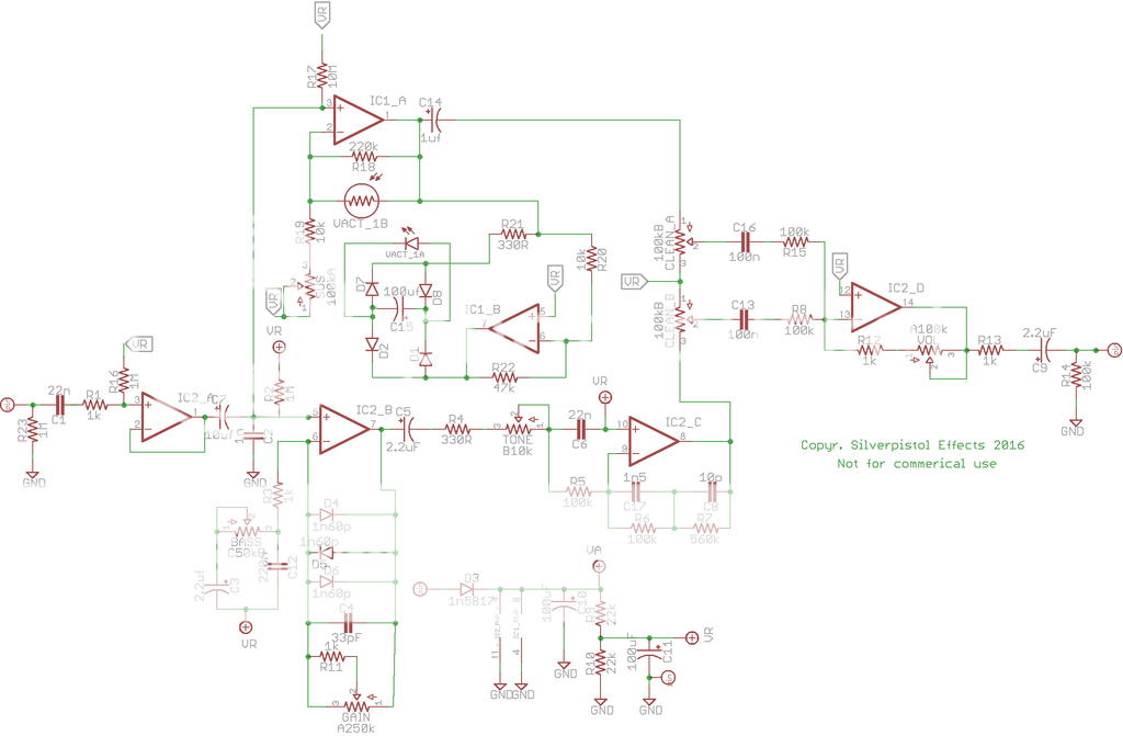

Hi folks,
Got a simple thing here: blending a Flatline comp with a TS variant.
I've gotten a bit overwhelmed with the variation of how to do blending/mixing properly and have ended up with a bit of a chimera of how the Pork Loin and Sparkle Drive do their thing. I thought the dual gang mixer was the best way to do blending so I went with that. I'm just trying to triple check that I've gotten the mixer part right - I've buffered the input, which splits out to the two circuits, goes to the dual gang mixer and then has a master vol on the last opamp (which is inverting)
Is there any gotchas here that I haven't spotted? I'm wondering if I even need that input opamp buffer, and whether that could be put to use elsewhere, maybe as a simple opamp boost or something.
I'd be grateful if y'all could cast your eyes over it.

Post by deltafred »
tonymcbony wrote:A cheeky bump to ascend above the spam
Yes it's a PIA.
The blend should be ok but I would have added another decoupling cap between IC2_C output (pin 8 ) and pot CLEAN_B /3 (as C14 is for the upper path) and connected the pot 'cold' ends to GND. This way there will be no risk of adding any noise onto VR.
All opamps except the output buffer are non inverting so no problems with phase inversions in either signal path.

Post by tonymcbony »
Yes it's a PIA.
