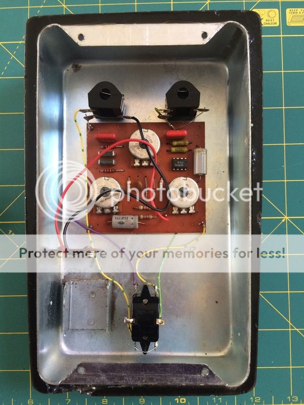

This just in. The housing appears to be resin. The two knob version also appears as the Guild Grizzly Fuzz, but with plain metal casing.

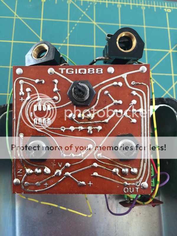

Thanks for the nice pictures. The only still unanswered question is: what is written on that brown ceramic capacitor beside the two diodes ?

tube-exorcist wrote:Thanks for the nice pictures. The only still unanswered question is: what is written on that brown ceramic capacitor beside the two diodes ?
You're not the first person to ask that question. Here's a photo from my Fuzz Sustain (before I sold it - dreadful pedal). You wanted to know what was written, but somehow I don't think this answers the fundamental question :D

tube-exorcist
Posts: 445
Joined: 05 Jul 2007, 20:09
Has thanked: 173 times
Been thanked: 67 times
Post by tube-exorcist »
Only this is written on it or a secret on the other side?

Post by nightraven »
tube-exorcist wrote:Only this is written on it or a secret on the other side?
I guess it's either the same on the other side, or nothing at all. Otherwise I'd have taken a picture of that as well. I seem to remember some confusion about this capacitor a while ago.

Just came across a schematic for this traced from photos by ciaran haslett over at tagboardfx about five years ago....

Post by Manfred »
i made a PCB clone for it, only the traces running under the Tone potentiometer are not visible.
I assumed that there is a trace ring around the potentiometer hole that connects the case to the PCB ground.
The part names are in accordance with the schematic above.
