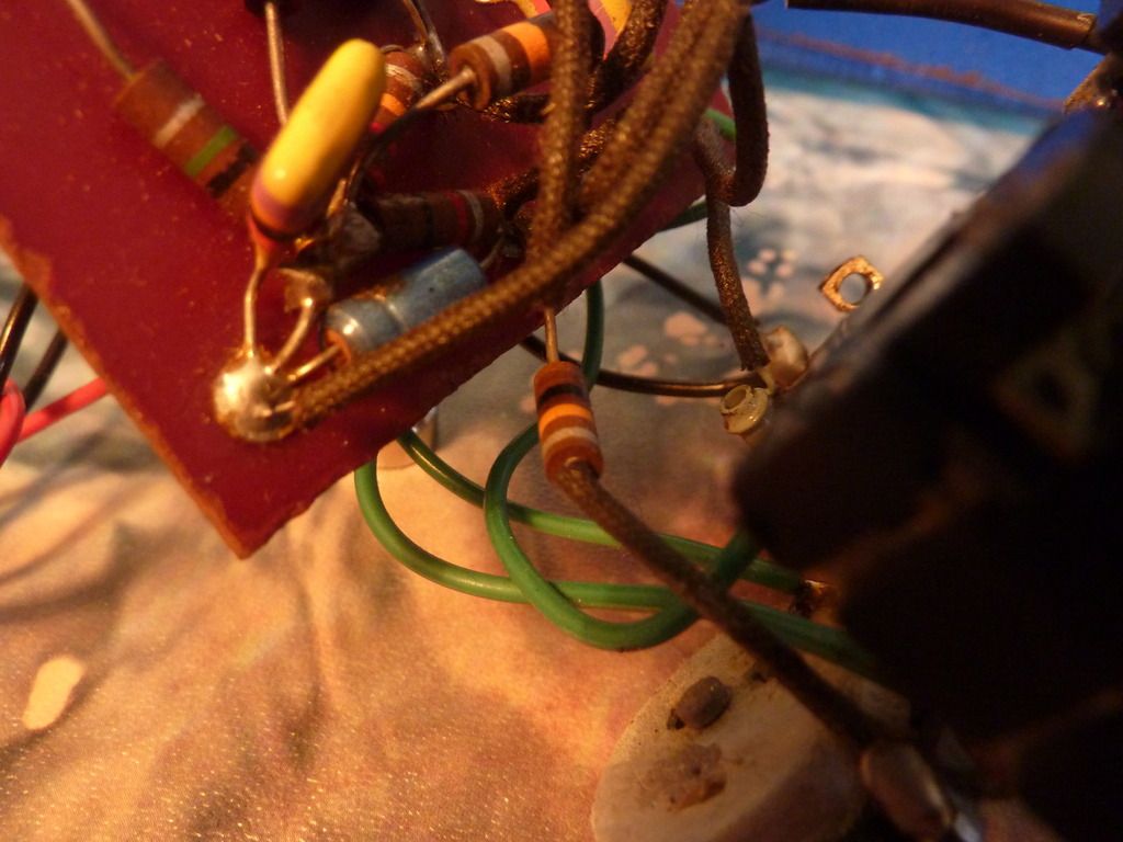

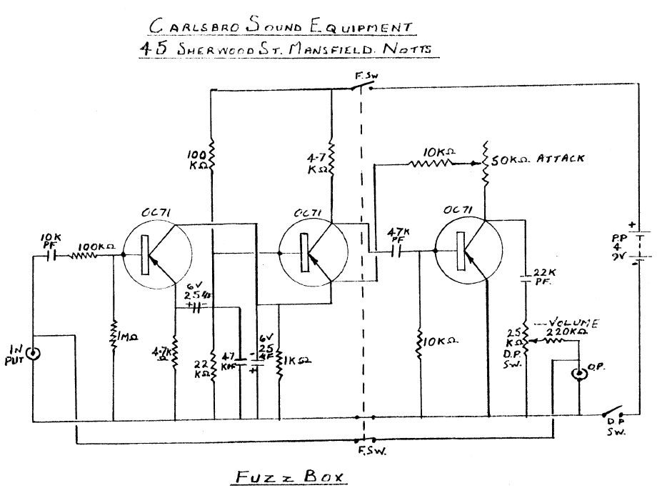

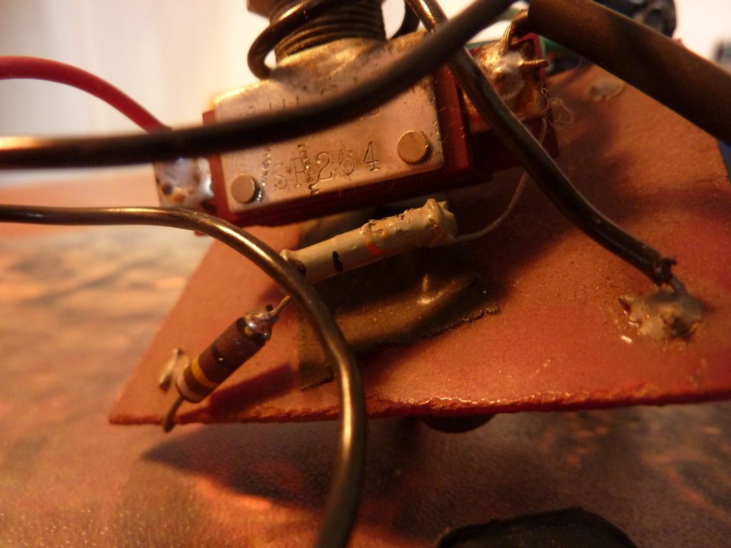

I scored this off eBay a few months ago. The previous owner said he bought it in 1966, which I thought was rather early, so I opened it up yesterday to see if the date codes on the pots disputed that. It seems to be an interesting part of the UK fuzz box story. Cosmetically it obviously harks back to the FZ-1. I haven't got one of those pedals to compare but the scale and size is probably spot on the same. Kinda the opposite of how Harry Gurst and co. were presenting a FZ-1 clone as something brand new, this thing actually appears to be a different circuit...
(credit to Effectsdataboob for finding the schematic)

BMS1971 wrote: 23 Oct 2021, 10:47 I made it, great tone, even with Hfe 40/50 cleans great with volume of guitar
What voltages did you have on the transistors?
I've redrawn the schematic so it's easier for others to read.
Can't imagine the output volume is much with that poor output impedance and the max headroom being not being too much above the ground rail

I decided to go way over my depth and try a replica of a Carlsbro Fuzz-Tone on phenolic board with eyelets and OC71 transistors in a wedge enclosure. Working from a few photos off the Web and the factory schematic.
All along the build I kept thinking "This will be a nightmare to troubleshoot". And here I am! I just fired it up and getting a totally clean signal about unity gain.
So before I dive in to troubleshooting I wanted to ask what's probably a very obvious question. The factory schematic (as posted above by nightraven) shows 9V negative to earth and positive applied to the circuit. Being PNP I assumed this was just an error. Am I correct in that assumption?

Pulled it out of the enclosure and it works. So answered my own question about negative voltage. I'm guessing it's a bad solder joint somewhere (earth wire dropped off when I was removing it from the enclosure, might be it? ). Also busted my brand new tropical fish output cap in half, delicate little things.

Strange stuff, only the schematic of this page works:
http://tagboardeffects.blogspot.com/201 ... zzbox.html
IF you change the 47UF by 47nf...
And 1/2 of the schematics have negative ground 1/2 positive ground.... So is there an actual right schematic out there?

I used the factory schematic that Nightraven posted at the top of this thread and also compared it to the photos of original pedals (by colour code) while I was figuring out the original layout. I'm certain it's 100% accurate except for the way the battery polarity is drawn, that's backwards and should be 9V+ to earth. Your MP41A transistors are PNP like the original OC71 so definitely need their juice from the negative side of the battery.
The schematic TWSpedals posted above looks 100% as does the layout by Manfred.

yes after correcting the polarity problem it works fine. Next I will try the bias adjustment and MP21A transistors
