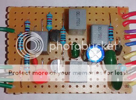

Anyway, I was thinking about how useful a power pot would be on one of these given that I never go much past 9 o'clock on the bloom knob (I actually do a lot of fingerpicking and the note separation on this thing is so phenomenal that major and minor seconds sound great even if you let them ring), so I wound up cracking open the doom bloom... I'm FAIRLY sure the schematic is on point. If you've never heard one, the head knob is great and I was blown away to see it involved an LED. Forgot to ID the diode in the power supply before putting it back together so I may wind up cracking it open again in the next few days and retracing a few things just to make sure, but it looks enough like the original that I'm... maybe 98% confident. That 2% is pretty much limited to the values of the 47pF and 47nF (0.0047uF) capacitors and which side of the 100 ohm resistor the transistors hook up to. Pretty sure tho. First pedal I've traced and drawn up a schematic for so you know, grain of salt etc but also yay me :horsey:
In the thread on the original somebody said something to the effect of "why did he glue the pots in place, why not just use PCB mounted pots?" Looks like he took the advice or at least had a similar revelation. Note the ungrounded output jack
Gut shot... apologies for the romantic lighting... helps me get in the mood. pretty sure all those monstrous 105j100 capacitors are 1uF
disemboweled...
Other side of the board, if youre interested in checking my work

thanks, also looks like ive got the power and ground swapped in the layout diagram just FYI... first draft v sleepy
+ error in the wiring of the output on the footswitch + the front-mounted LED's are reversed... ignore the layout diagram p much

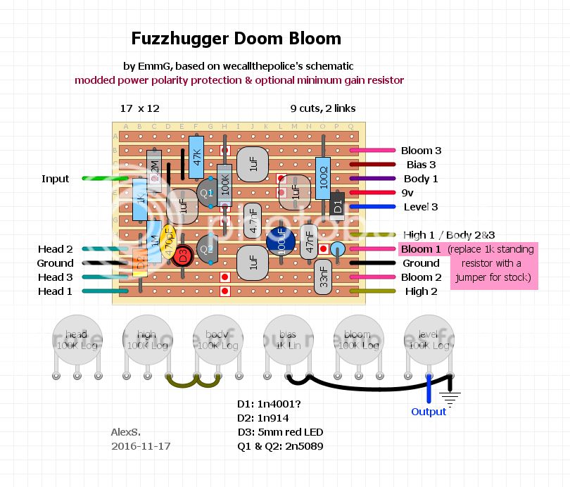

My first layout, so all corrections and advice are appreciated.
I was unsure of two values. The filter cap is 47n on the trace (and looks about the size for a greenie on the photo) but 470n on wecallthepolice's schematic. He was also unsure if the input filter was 47p, so I went with the value on the original Algal, which is 470p.
I also suggest adding 1k later on from Bloom's lug #1 to ground, to not kill the signal at lowest gain.

The above layout has errors, sorry. The high and low pots are not working correctly. I will change according to wecallthepolice's trace, instead of his schematic.
Re: Fuzzhugger Doom Bloom [gut shots] [Schematic]
Posted: 16 Nov 2016, 09:16
by EmmG
Here is an update. I rewired the body and high pots according to the TRACE. They must have gotten reversed when being transferred to schematic. Wecallthepolice, does your "body" control CUT bass as you turn it clockwise?
The high cut cap in the photo says 333, making it 33nf, not 330nf, which is why most of my signal was being cut.

Easy hack implementing the power protection discussed at tagboard:

Last one... I strongly recommend the minimum gain resistor. You may prefer a higher value.

thought the value on the cap itself was too faded to read and the meter was giving me weird values, hence the confusion, but it looks like it's definitely a 470pF at the input
looks pretty definitively like a 471 (at least to me IRL... wound up being difficult to capture on the phone cam)

I removed the older unverified layouts. If it squeals too much at high settings, try raising the 470pf, or place it after a buffered pedal. Here is a pic of my working build.
