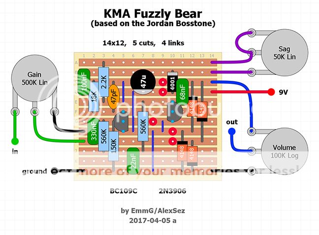

Thanks, Carlos3350. I gave a layout a try:
Audio clip:
I built it before realizing the gain pot cuts all signal at minimum. If this bothers you, add a 1k resistor between Gain #1 and ground. You can fit it on the board by connecting to ground elsewhere and adding a standing resistor and another cut. You could also make the board one column bigger on the left and add a cut. I would leave the gain high and control with your guitar's volume though.
If you already have a Bosstone built, experiment with the larger caps and voltage starve. I've seen voltage starve as a popular mod on Bosstones, the Rockett WTF comes to mind.

Can I ask which is the 2nd transistor? the PNP one (to126?)
EmmG
Posts: 75
Joined: 11 Nov 2012, 02:03
Has thanked: 18 times
Been thanked: 46 times
Post by EmmG »
Updated layout with minimum gain resistor and pics of my build:
Image Image
