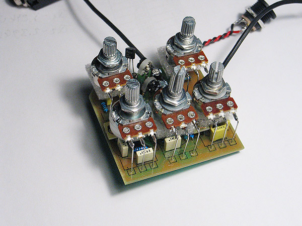

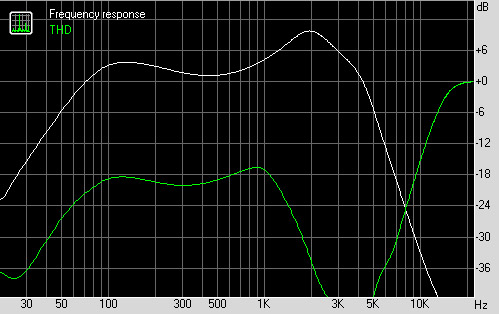

#1 - Multicab SIM by dschwartz. Four knobs (bottom, gain, flatness, top response). Bottom knob - 3 o'clock, flatness and top response 12 o'clock.
And a frequency response taken with RMAA with the same settings as recorded sample (this applies for all tested 8 cabsims). This one on a PCB and is boxed.

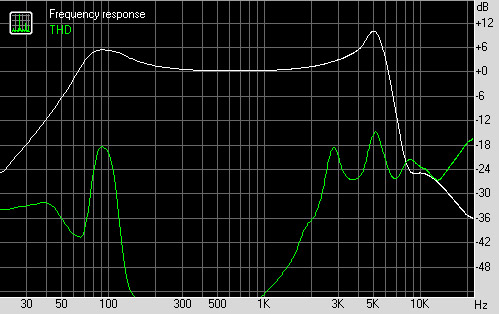

And all the frequency responses on one graph (amt, hotline and distorque on red, but I do not know how to change colour of the plot line).

I got a very similar response from the Victor Kampf circuit. I'm curious if some of the parts values are wrong, as the stages don't match up with how they are aligned as described here:

Here's the amt cabsim frequency response from ltspice model. It rather matches the one from AMT article.
It is possible that frequency response presented on AMT website was not taken from the working circuit, it's only theoretical response. Another possibility - wrong parts values, different transistors - different results.
