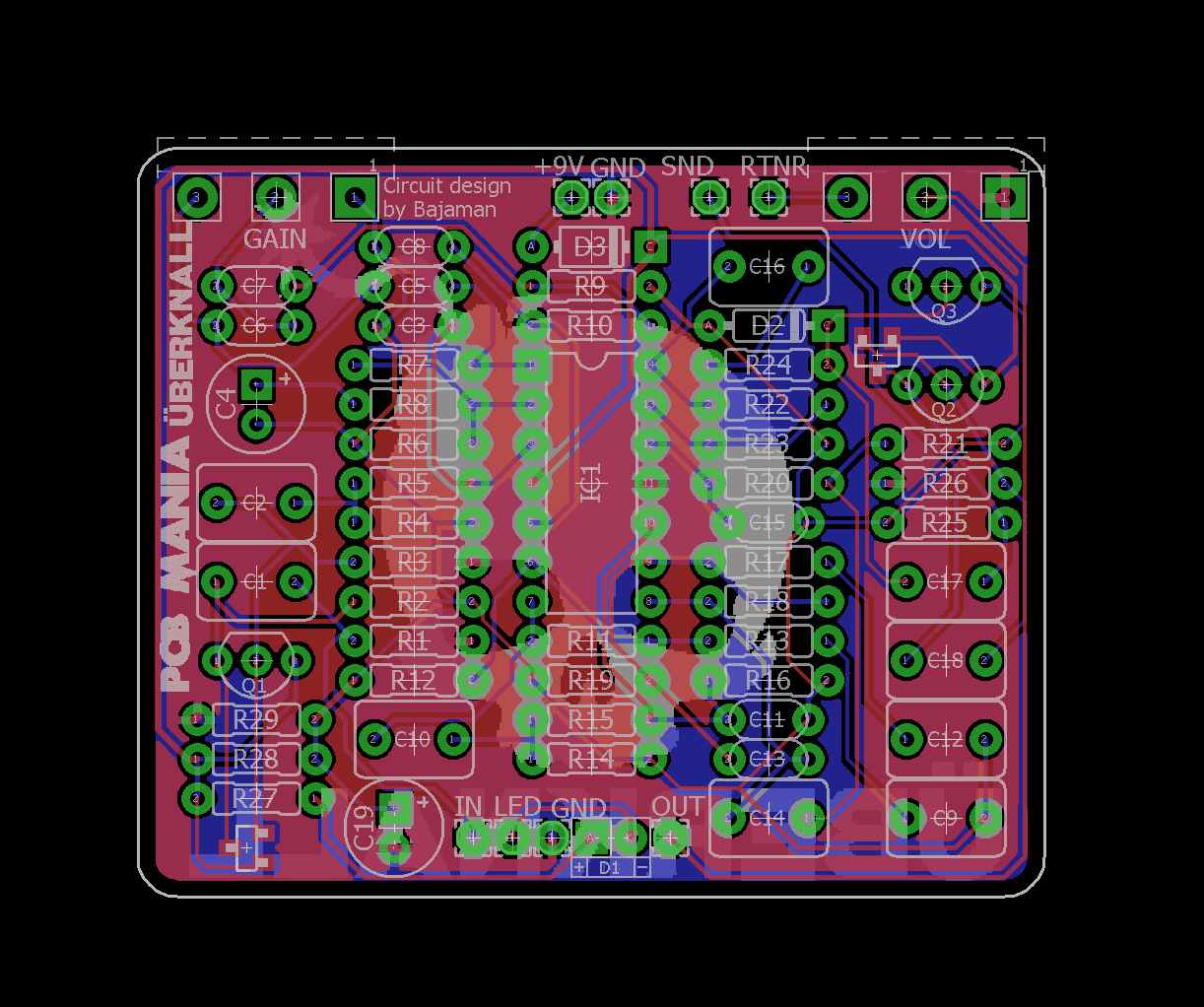

by sego91
I made this board for the BAJA UBS and I'm more than happy with the ton I can get out of it! :D :D :D
I've designed it with the send and return pads so its possible to attach and try out different EQs, so far I've tried it with the Amp tone stack + Recovery gain and I really like it, pretty loyal to the amp sound tone wise, and I've also tried out a Hybrid EQ that mixes a Baxandall for Low and Highs with an Active mids control, giving me a really interesting result as well, pretty flexible to shape this amazing drive!
I'll keep on researching and I'll be making some videos testing with different tone stacks :D :D
Also I just found the new Baja update for extra gain, and as far as i can see i could replace those values on my board to try it out, maybe on the final version it could be a DPDT that switch in between the original version and the new one with extra gain... But I should try that out first :D :D
Hit me up if you are interested in some boards :)
