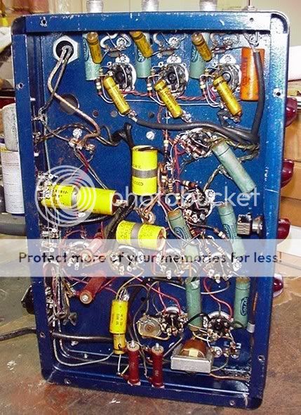

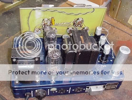

You didn't mention what kind of Voltages the amp sees. There's a lot of tones in one of these.
Click to open it and I think you can see the whole thing.

wow ,I am enjoying....great amp.....are those metal tubes in the preamp?
I have around 380V -400V........not sure.
