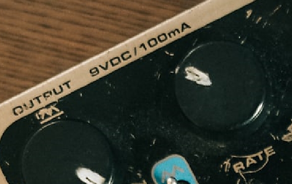

I got this big box 3 knobs pulsar tremolo,on the box it's written 9vdc 100mA,ok, fine,but inside there was a 78l09 regulator between the DC Jack and the circuit,where also the 9v battery connects.
Does it mean that EH power supplies were supposed to be 12v,or maybe 10 unregulated?
Because it's clear that feeding 9v in that regulator won't work properly.

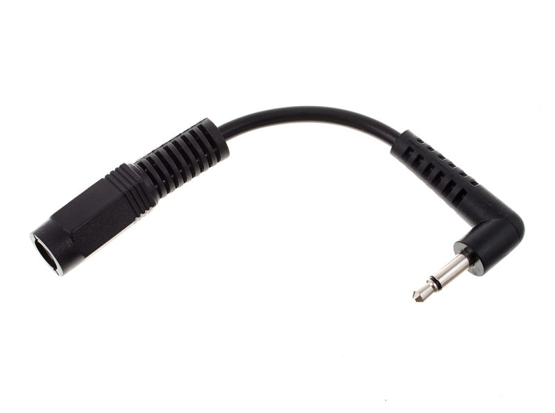

I also measured an older (3.5mm plug) EHX 9V/100mA power supply : 11,95V
Too bad I can't remember which pedal it came with. My guess is a big box Big Muff or Double Muff.
Here's a picture of the adapter:
I'm surprised how much better my big box Pulsar sounds with it!

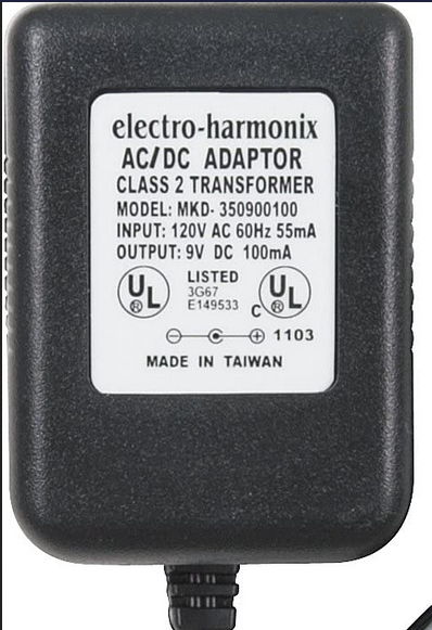

I've just checked the EHX power supply that i got when i bought my Pulsar (second hand). It's delivering 15.5VDC on its output, although it's being sold as 9VDC.
Hence the 9V regulation then.
EHX 9V PSU.jpg (36.15 KiB) Viewed 2238 times
ps: it's the old "mono jack" plug type PSU...

It is somehow. The old Boss PSUs were unregulated and the current draw was dropping the voltage down. If you look at the EHX label, it clearly states 9VDC @500mA, but delivers 15V unloaded. The regulation is just inside the unit, not in the PSU... That answers the OP.
