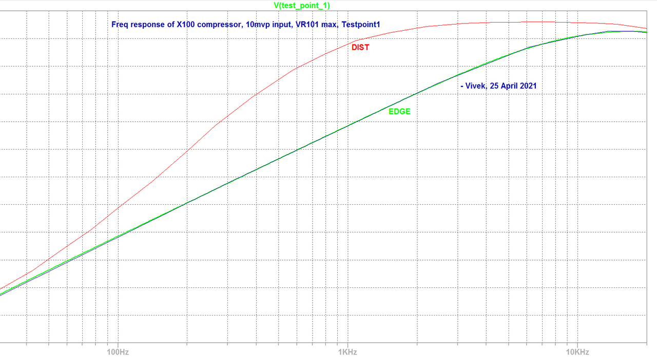

After we decided to modernise the Chorus on the Rockman X100 by using modern parts like MN3207 BBD and CD4046 PLL,
and decided to add new controls like LFO speed, Chorus depth and Chorus delay time (while making sure there is a setting that replicates the Rockman)
We took an existing topology of LFO and clock that used the components we identified, and began SPICE analysis and re-design of the schematic to make sure that it covers the specifications of the Rockman X100.
I made multiple SPICE models of the same FET 2N4339, at Vgsoff -0.6, -1.2 and -1.8
so that I can study how a circuit behaves if a different FET with same part number but different Vgsoff within the published range is inserted instead.
This helps me to determine the correct trimmers to have around the FET, to accommodate the range of Vgsoff as per Spec sheet.
Indeed, the Rockman compressor behaves very differently based on the Vgsoff of the FET
In the last 10 years, I found that there are many posts by frustrated DIYers who complain that the FET in the Rockman compressor is impossible to bias. They also categorically stated that only the 2N4339 can work in this schematic.
This is most probably due to using FET with VGSoff outside the design range of the circuit.
On the other hand, we found from SPICE and breadboard that it is fairly straightforward to get the compressor working properly. In fact we managed to successfully use 2 different FETs (2N4339 as well as 2N5457) in the compressor and get equivalent results.

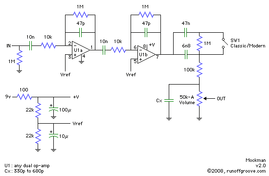

I decided to have a brief look at the MOCKMAN ver 2 schematic at http://www.runoffgroove.com/mm2.html, using LTSPICE.
Here is the SPICE graph of the Rockman X100 "Complex Filter" that is considered by many to be the first Cab Sim for maybe the first Amp in a Box in guitar electronics history
and here is the Frequency curve of the MOCKMAN :
Please draw your own conclusions about the similarity of these two circuits.

Frequency response of input and output of the X100 compressor in DIST mode and EDGE mode (Not the total response of the pedal, its only the response of the compressor)
EDGE mode has a serious bass cut/treble boost filter before entering the compressor. This is normally done to avoid overloading the compressor with high energy bass signals. In EDGE mode, the compressor itself has flat frequency response so the output frequency response is same shape as input frequency response, shifted up by the gain of the compressor.
Normally, the bass that has been taken out is restored in later stages
As compared to EGDE mode, DIST has a big mid boost filter at 1Khz. This is before entering the compressor stage. There is still a very high bass cut. In DIST mode, the compressor itself has flat frequency response so the output frequency response is same shape as input frequency response, shifted up by the gain of the compressor.
The mid boost in DIST mode is so much, that the compressor also distorts the mids but does not distort the bass. This adds to the flavour of that particular sound. This is one of the reasons that other clones were so off the track !!!
