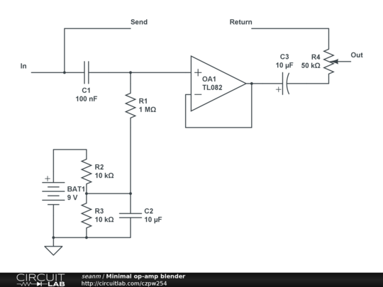

I've been using the Ultimate drive on bass as-is, and it works quite well already, especially in the "low" setting.
In addition (as i'm adding a fuzz that eats all the low-end) i've built a simple blender pedal.
I only give negative feedback.
