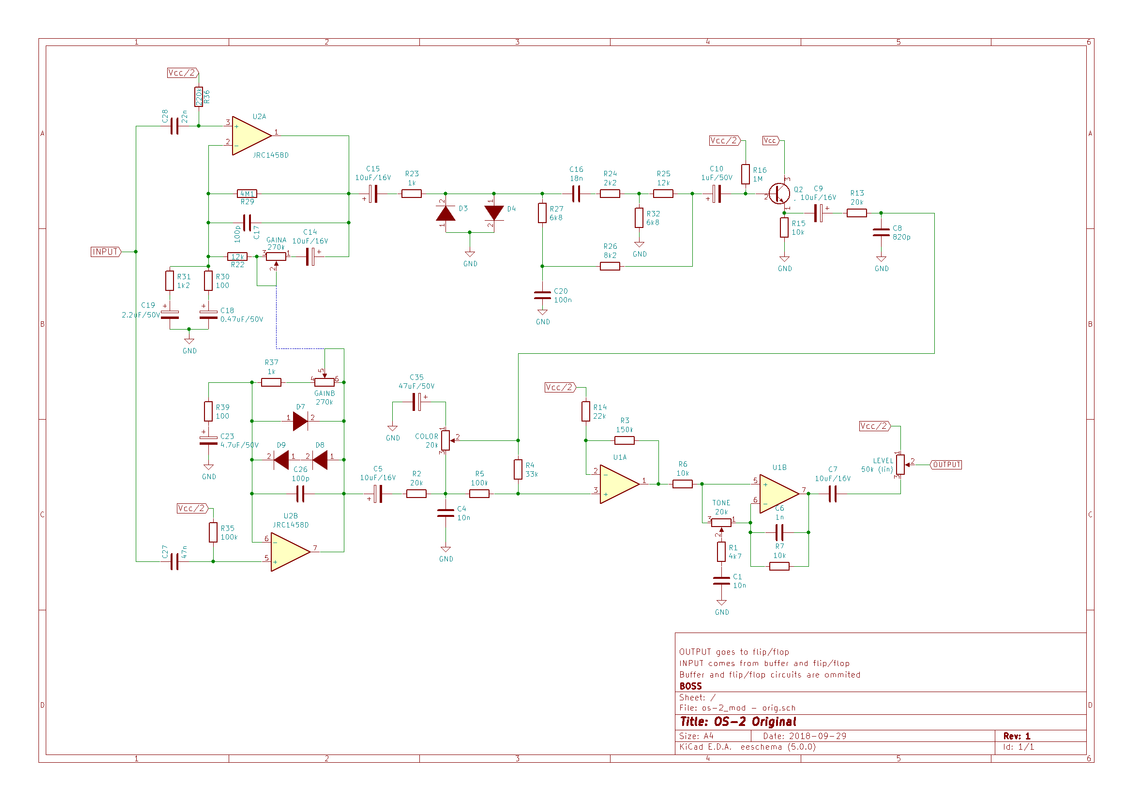

Here's the schematic in case anyone can help to explain why it might happen.

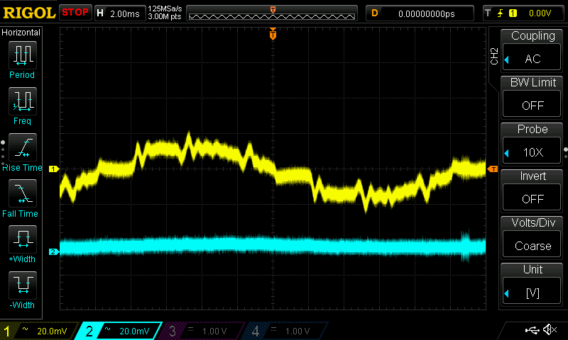

I'd start with turning AC coupling on your scope, setting probe to x10 and probing on those points (w/ your cord plugged and fx in active and bypass mode)
Also, do check your cord for possible shorts. In some cords, there is additional black carbon-PVC sub-shielding (electrostatic shielding), right under the copper braid. In no case it should contact the signal wire.
Scope looks like:
With effect on
With effect off
Yellow is at R34 and Blue is at R40

Hey, can you also probe the gate of jfet, just for reference, please?
Yep, Q04 is oscillating and this whole mess is being amplified by the gain stage.
Still, 150pf after 10k is roughly 110Khz cutoff, which is pretty low for your typical jfet to start oscillating. I'd assume that Q04 is faulty. Or maybe not. Still, Input decoupling cap is a musthave.

This thread is somewhat old, but I write to say that the schematic at the beginning is wrong. It was extracted from my blog, and recently user Jimilee discovered a mistake in it. Pin 2 of color pot is connected to vcc/2. Below you can find new updated schematic:
