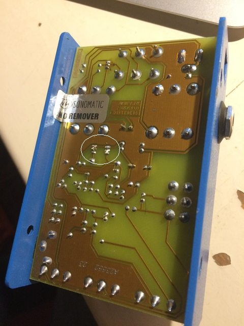

Anyone know this pedal Sonomatic Doctordrive 2 , made by a company in Buenos aires Argentina and billed as a 18watt amp emulation
It appears to have one opamp & two transistors but if it's a yats it sounds pretty good for a med/ lo gain pedal

Unfortunately there is scarce information about this line of boxes in my country.
Here is the only image found in the web, with a clever idea where to put a warranty sticker:
Looks like not to have an op-amp inside... :hmmm:

ppluis0 wrote: 20 Dec 2020, 04:29 Looks like not to have an op-amp inside... :hmmm:
I disagree :)

Exactly , I can't find a website for these guys, though I see someone selling their version of an 808 on reverb, Similar case form factor, which is compact and sturdy, well designed I think.
i fixed one for a friend that the dc protection diode blew when it was plugged in hot, it arched which was heard. It didn't have the warranty sticker i took some images [ can't find them atm ]
the fat / sharp switch changes the gain structure enough that you have to change the other settings, but gives you a couple good angles at the sound.

Hi FiveseveN,
You're right, AGAIN !!! :applause:
Now, after your confirmation that there are a dual op-amp inside, my best guess is that the two components within the circle (ellipse, anyway... :D ) may be a couple of 2N7000 connected in anti parallel ? :hmmm:
If this is correct and looking the tone switch that can be viewed in the front image, this unit is nothing than another clone of a Fulltone OCD :roll:
I think that the quality construction of this box looks professional but they simply build copycats of established models and does not design anything new, same as the others local manufacturers in my country.

At first glance (TL082, two 2N7000, 1 Ge diode, potentiometer values...) this board appears to be a clone of a germanium OCD, but who knows... :hmmm:

Tracking is in progress.
Not all component designators are recognizable as well as the color codes of the resistors.
If someone owns the pedal then please enter the missing part names and part values in the following image of the part page or correct the already entered values if necessary.

I have just finished the tracing and have drawn the circuit diagram by hand, which I will soon draw with the electrical CAD.
I can say in advance that circuit came to me familiar , it is very similar to the VickAudio TreeOfLive Overdrive.
There are few changes in the schematic structure plus the Millennium Bypass circuit is used.

I must have been blind, it is indeed an OCD clone. the circuit structure does seem to be the same,
I will compare the resistor values on the picture again.
