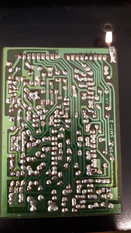

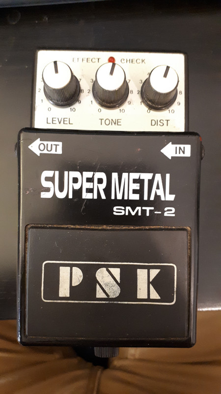

As I continue my quest of identifying cheap vintage boss clones I found this pedal.
And from what I traced it is... a boss HM-2 Heavy Metal clone. Layout is almost identical, the only difference I saw is the fact that the PSK only has one tone knob, what happens in the circuit is that the tone pot on the pedal is the HM-2's high pot and it's acting as if the low pot was maxxed out, but the cap linked to it (C35 on the HM-2 schematic) is 1µf instead of 1.5µf. A little less low then, easy mod to add it.
Apart form that, it's identical... same IC's (M5218), same Germanium diodes, etc.

I have an old smt 2 but some of the wires have come off around the pots. If there any chance you could post some pictures of the wiring for me please?
Cheers!

aurvoy wrote: 20 Dec 2021, 22:10 Hi,
Cheers!
Alexis
Sorry I just saw your message. Did you sort it out already ?
