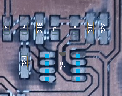

aionios wrote: 28 Nov 2021, 21:12 Here's the updated schematic
I think the C16 should be connected at the other pin of the R20 (=IC6 pin3).
aionios
Posts: 208
Joined: 22 Mar 2012, 00:12
Location: Des Moines, IA
Been thanked: 369 times
Post by aionios »
x-tn wrote: 07 May 2022, 13:41 I think the C16 should be connected at the other pin of the R20 (=IC6 pin3).
It looks like an error, but it's actually correct to the original unit... here's a closeup:
C22 is my C16 (cap to ground), R30 is my R20 (resistor to +) and C16 is my C17 (cap to -). It's a bit low-res, but the traces are all connected along the top row and there are none on the underside of the board.
It definitely looks like a mistake... especially considering that this section is very similar to the Microtubes which has the cap at the noninverting input. Darkglass may have made a mistake in the Duality design or it could have just been a quick & dirty fix to change the filter frequency without any extensive changes. But either way it's correct, and seems to have persisted across seven different revisions so it's just part of the unit's sound now.
