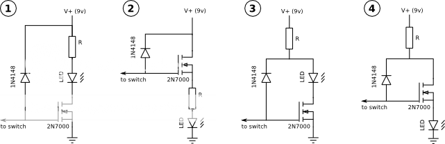

For the millenium bypass i usually use the scheme at (1)
would variations 2,3 and 4 work as well? Would it make any relevant difference for its use?

Howdy, I have a question! :D
I did a fuzz face, positive ground.
NOW WHAT?! :shock:
How should I make the millenium bypass using the top left schematic?
Details:
I discovered from my experience that the fet is inverted, it should be making a C| shape pointing the right side.
The led is also inverted.
I'm using this schem because here in portugal i can only find bs170's :(
Thanks in Advance :mrgreen:

I have Octavia with positive ground.......tried millenium with bs250....burned 3 of them ,and no luck.........did somebody make millenium for positive ground???
boris

should be able to do the above and just switch around any polarized parts.

borislavgajic wrote:I have Octavia with positive ground.......tried millenium with bs250....burned 3 of them ,and no luck.........did somebody make millenium for positive ground???
boris
There are two positive ground ones shown here:
http://www.geofex.com/Article_Folders/M ... milckt.gif
I recommend trying the one with the P-channel JFET. I've had good luck with JFET Millenium.

yep. also, i meant to mention, in the above schematic where fuzzed mentioned the mosfets being reversed, this is only true of either the 2n7000 or bs170. Fairchild 2n7000's generally have an opposite 180 degree pinout form the normal bs170. just some info.

I made the millenium 2 (http://www.geofex.com/article_folders/m ... millen.htm) using a BS170 and a collector-base junction of a 2N3904 as the low leakage diode. LED won't turn off. Stays on both when circuit (base of BS170) is connected to ground and not. Am I missing something?
R.G.
Posts: 337
Joined: 22 Sep 2007, 02:24
Been thanked: 39 times
Post by R.G. »
You have made a mistake in wiring the circuit.
This commonly happens when you get the MOSFET backwards, as there is an internal diode from source to drain. If these are swapped, the LED stays on forever.
There are other ways to get this problem, but this is the most common. One other way is to have a dead MOSFET by having punctured the gate insulation with static electricity.
By the way, the low leakage diode is there as protection for the MOSFET gate. It's not needed for the basic function. The high leakage diode *is* fundamental to the circuit operation, and if there is a secret to how the Millenium works, the high leakage diode is it.
