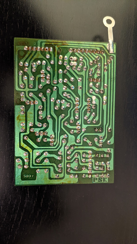

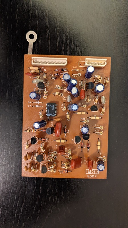

Hey everyone.
I stumbled upon a "old" psk boss clone, which turns out to be a rat with asymmetrical soft clipping, with buffered bypass... or a sd-1 using a LM308, if you'd prefer.
I tried to find some other pedals like this one, but I couldn't, does anyone know about some already existing overdrives using lm308 / rat with only feedback diodes clipping?
Here are some pics, and a schematic from what I traced :
PS : yes R2 is 470 and not 47 ohm

I just dis overed that the proco brat/roadkill is just about the same pedal, if you add hardclipping diodes in the unpopulated locations.
But... The psk pedal came way before the Brat :)
