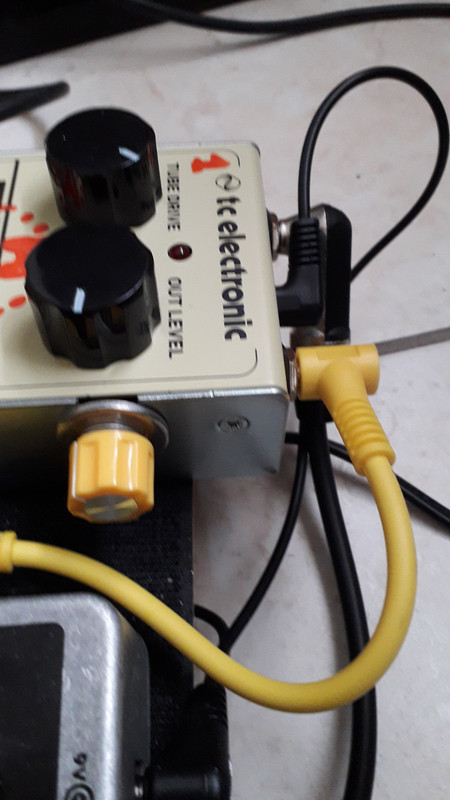

Ain't got the time to trace the schematic of the unit. Anyway, there's a lot of SMD components in it and my eyes are getting old.
But I've added a tone control to both of my TP's.
I've first tried a tone stack like in the Butler Tube Driver. Nice but (as expected) there was too much insertion loss.
So I've tried something simpler, in parallel with the smoothing cap already there (itself reduced @ 1,7nF thx to a 1nF + a 680pF in parallel in this case). Recipe applied:
-center lug of the volume pot to center lug of a LOG 50k pot (I insist on "LOG", not linear);
-ground lug of this tone pot to a cap of a higher value than the smoothing one;
-end of this higher value tone cap to ground lug of the volume pot.
With 47nF or 22nF caps, It works half like the "presence" control of a Hot Cake, half like a "contour" control on old Marshall Valvestate's.... It's not really useable at zero (where it mimics the tone stack of an amp with bass full up and other controls zeroed). Maybe then it would be better to add a resistor to limit the amplitude of the pot but it's a detail...
The tone pot is easy to install on the right side of the pedal, perpendicular to the volume pot and next to its axis, between the back of the PCB tube socket and the input jack...
The bottom housing is made of soft metal and relatively easy to saw: On the top of the right "wall", I made two vertical incisions of 1,5cm with 1 cm between them then worked the small bit of metal with a plier until I could break it. It opened a rectangular windows of 1x1,5cm @ 9cm of the lower bout and 2,9cm of the upper side, giving enough space for the pot. Then a pair of washers and a screw was used to attach the whole thing to the metal housing...
I should have done that before since I'm very pleased by the effect of this added control: without too much volume drop, it gives big bass and scooped mids on request and tames the "raw" upper mids of the TP in a musical way.
EDIT- I've realized that my two TP's didn't react so well to a same tone cap value (which seems understandeable since they never sounded identical, even when they had both the same stock Bugera Tube). My various amps didn't react equally well to the added tone pot either. So one TP has been left with a 47nF tone cap and the other, with a 22nF. A 10nF was expected to work since it's a value often found in pedal tone circuits but in this case, it failed: by diminishing high frequencies without scooping enough the high mids, it was just muddying the sound.
EDIT, bis - Also forgotten to precise that I often use my TP's after a treble booster or pre-drive FX goosing the (high) mids. Hence my move towards a darker high-midrange, as allowed by an added tone control. For those using a TP alone, letting the added tone pot full up or not lower than 6/10 would be logical to avoid a too bassy response...
FWIW.

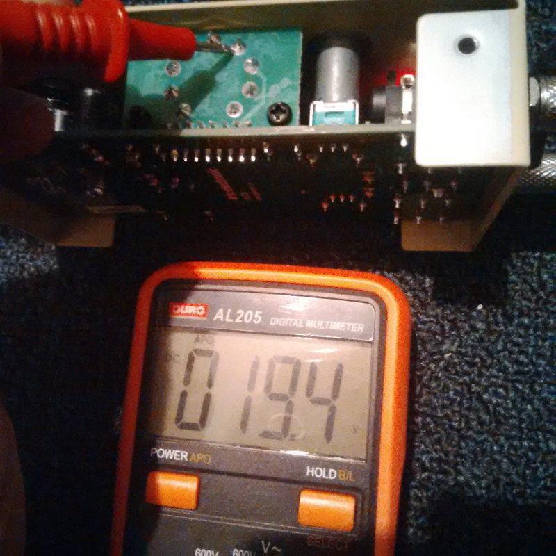

Hello
I recently bought a tube pilot and it is awesome! But as already everyone mentioned it sounds harsh and very trebly. I tried the mods people suggesgted. They worked great but it did not work flawlessly. Around 10 to 4 o clock the pot did nothing. When rolled extremely low it worked but sucked out all the treble and the volume dropped massively. It was hard to dial out. So what i did was add a tone pot in series with the volume. It was not useful for me so what I did was:
First I desoldered the middle pin of the volume pot and lift it out of the hole. And soldered a wire to it
Solder another wire to the hole of the middle pin.
Then i connected the pad and the lug of the pot with a 100k resistor.(I initially tried 470k but 100k was better. Maybe a lower resistsnce would sound better but I don’t know.)
I soldered the wire coming from the lug of the volume pot to the new pots left pin(while looking at it from the back)
Then soldered the other wire to the middle lug of the new pot.
Lastly To the right lug of the pot (while looking at it from the back) soldered one leg of a capacitor(which is 0.047uf) and soldered the other leg to ground. To make the ground connection better i used the pots back and connected a wire to a ground.(I don’t think that this is needed but I did it anyways)
The pot i used is 22k
Keep in mind that I am 17 years old and I lack a lot of knowledge. All of the values are guessed. I am pretty sure that someone will make better suggestions for the values of the parts used. After doing this mod the pedal sounded really good to me. It still drops volume but the harshness is gone and it could be used as stock with this mod if needed. Just turn the tone pot all the way. I hope that this helps someone that really likes this pedal but hates the harshness.
Note: Do not drill the hole where I have drilled it. It turns out that it is a really bad place.
