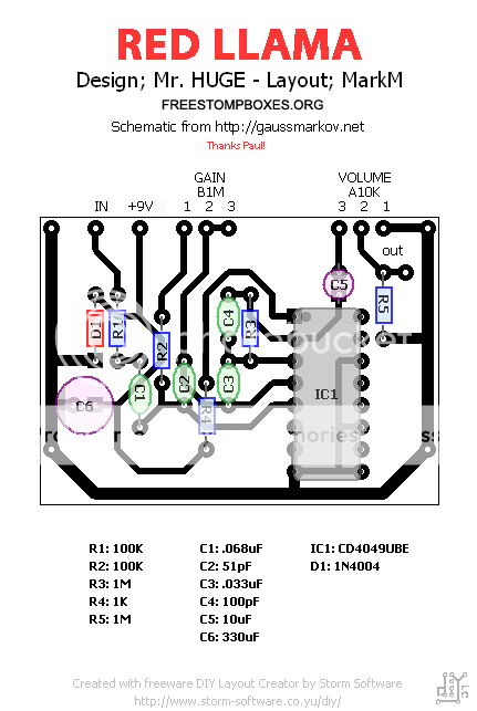

Cleaning up some stuff, here's MarkM's transfer and layout files for the RED LLAMA / Craig Anderton's Tube Sound Fuzz:
markm wrote:This circuit seems to rollercoaster in popularity.
Classic circuit based on the Tube Sound Fuzz.
https://i17.photobucket.com/albums/b72/ ... YOUT-1.png
https://i17.photobucket.com/albums/b72/ ... ANSFER.gif

modman wrote:Was hoping to find some more info on the Tube Sound Fuzz/Red Llama comparison value wise...
Rota?
I've been messing with the two layouts. Hang tight and I'll report back. For a nice and quick change, swap R2/100k on MarkM's layout for a 10M as called for in the original TSF schematic. The original had a Lead/Rhythm switch that swapped between the 100k and the 10M. Way Huge dropped the 10M. The upside to the switch...huge, fat, greasy, sustaining fuzz. The downside...you can't adjust the gain, it's fixed.

Can someone tell me what value C5 is and where I can find C2? - couldn't find the value at Small Bear and the pots are 1M and 10k linear correct?
http://www.aronnelson.com/gallery/main.php/v/Bean-Box-Shop/beanLayouts/redllama.gif.html

C5 is listed as a 100pF. C4 is a 330uF in the Red Llama build but it have been written that anything between 100uF and 330uF will work fine. Pots are an A10K for volume and a B1M for gain.
RLBJR65
Posts: 280
Joined: 30 Jun 2007, 16:07
Location: USA
Post by RLBJR65 »
C5 is 100 Pico Farad (pF) = .1 Nano Farad (nF) or .0001 Micro Farad (uF or mF)
C2 - 51pF = .051nF = .000051uF or mF
Mouser - http://www.mouser.com/ Futurlec - http://www.futurlec.com/Components.shtml
among many other places will have them.
The Rotagilla
Posts: 736
Joined: 20 Aug 2007, 18:24
Post by The Rotagilla »
Sorry, I thought Beedola was looking at C4, not C2. :oops: Too early in the morning for me. [smilie=sleep.gif]
51pF is Mouser PN 140-50S2-510J-RC

Maybe old but here we go:
http://gaussmarkov.net/wordpress/circuits/red-llama/
Partlist for the Red Llama Clone on gaussmarkov.net
Part Value Library
C1 .068uF gm-caps-film-box
C2 51pF gm-caps-ceramic
C3 100pF gm-caps-ceramic
C4 .033uF gm-caps-film-box
C5 10uF tantalum gm-caps-tant
C6 330uF gm-caps-electro-pol
D1 1N4004 gm-diodes
IC1 CD4049UBE gm-ics
R1 100K gm-resistors
R2 100K gm-resistors
R3 1M gm-resistors
R4 1K gm-resistors
R5 1M gm-resistors
GAIN 1M gm-pots
VOLUME 10K gm-pots
