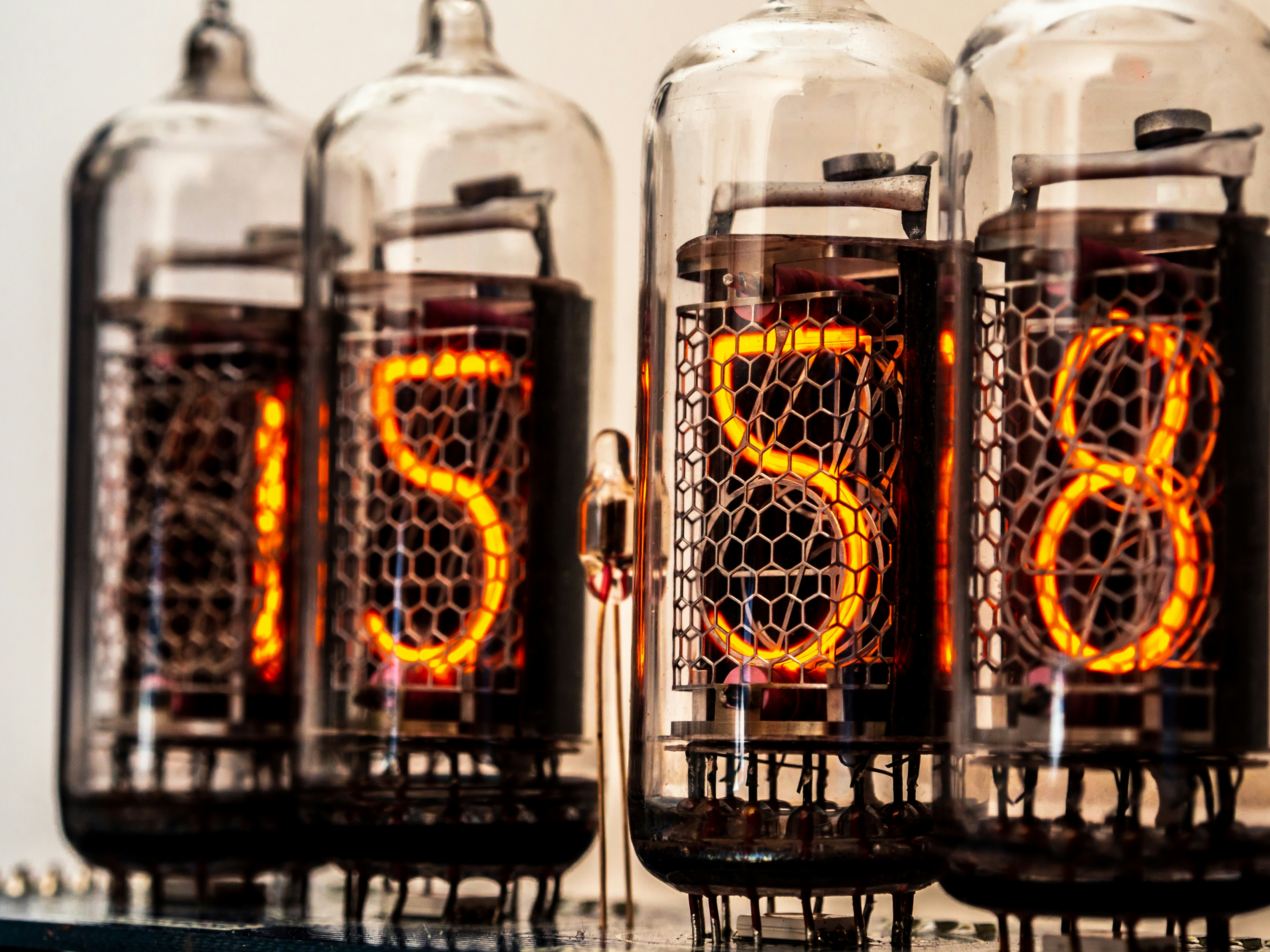

Manfred wrote: 07 Jun 2022, 23:25 I think it would have been even cooler to build the circuit into an old EL34 tube like a ship in a bottle. :lol:
Something similar as the nixies displays:

OP-Amp type analyzer with nixies display. :lol: :thumbsup
