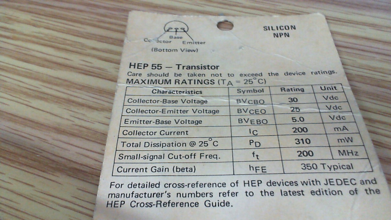

Post by ppluis0 »
Images found in the web 8)

Post by Ben N »
Looks like a 2N3904 would work just fine.
