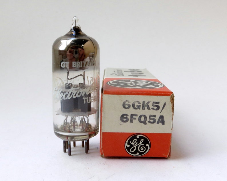

Nice project to experiment with vacuum tubes (Aka: valves) without involving dangerous voltages.
This same design can be implemented with an inexpensive TV tube named 6GK5:
This miniature tube requires a 7 pin socket, measure 48mm in height, 19mm in diameter, and draws 180mA for heating (instead of 300mA as the tube originally proposed.)
P.S.: According to the current criteria, the two 741's should be replaced by a TL072, a RC4558 or similar op amps
