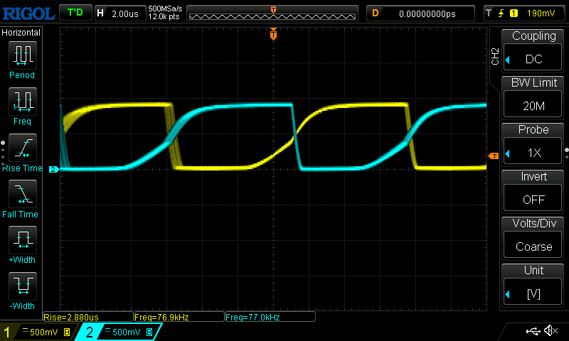

So I've built a small dedicated board with the MN3007, based on the Fender3D upgrade, as follow:
Basically I did:
  • change the clocks capacitors from 20pF to 15pF
  • change the two resistors for the bias adjustment
  • unsolder the SAD512 and connect the IN, OUT, VCC, CLK1, GND signals
  • pick the CLK2 signal
In the following tests, the MicroChorus is fed with the following test signal:
When testing without the MN3007 chip I can measure the following:
- GND (5) to VCC (1): 9V
- GND (5) to VGG (4): 0.6V
I can measure the following clocks signals:

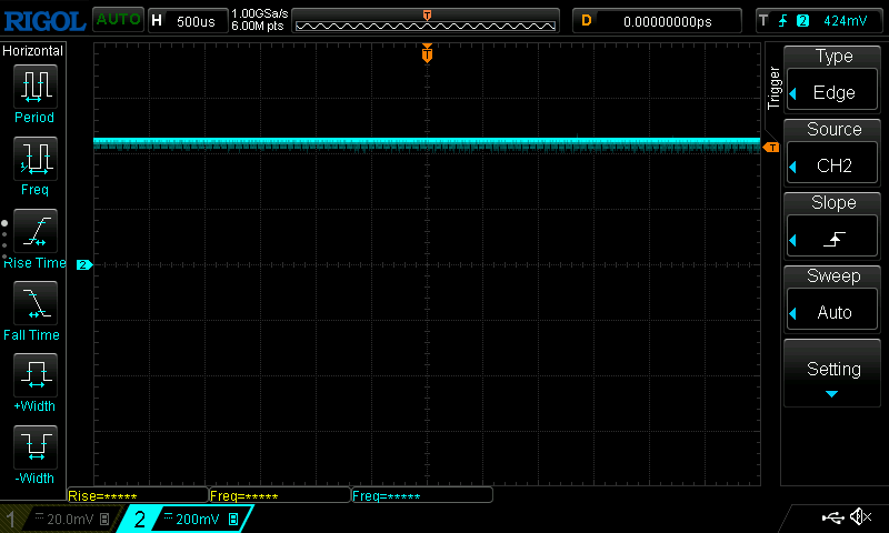

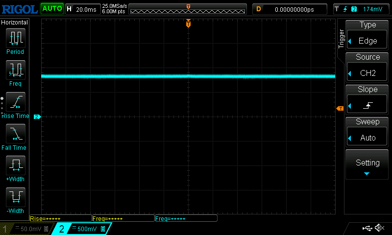

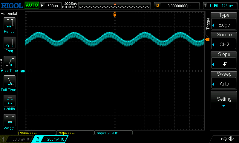

The input signal at pin 3:
And the output signal at pins 7-8 (basically coming from VCC, since the chip is not there):
Note: my son played with my probes, thus there's a x10 issue with the scope captures here :D
So the clocks looks good, I have a 4V bias as expected on the input signal.

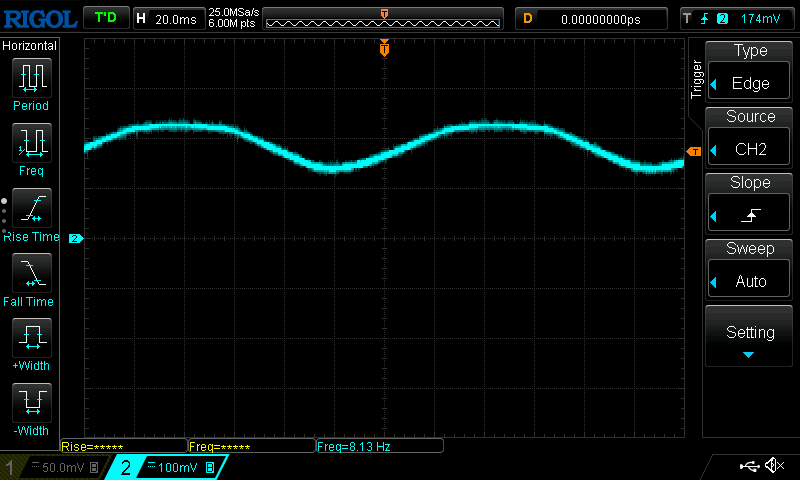

Now if I connect the MN3007 chip:
- GND (5) to VGG (4): 1.9V

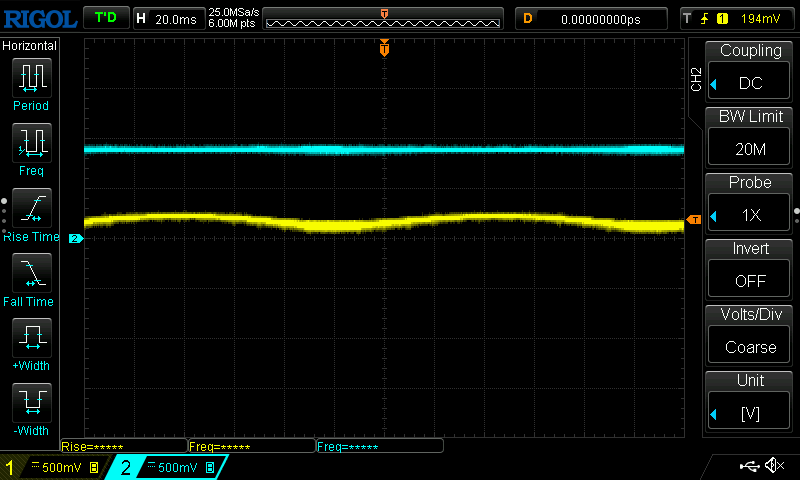

And the output signal at pins 7-8:
There is many odd things here to me:
  • What happend to the clock signals?
  • My input signal is now a 8Hz signal with a 2V bias
  • The output is flat
I did try with 7 different MN3007 chips with basically the same measurements.
Am I missing something obvious here?

Sorry for the late reply, MNs chips usually are clock-hunger chips, than SADs...
Just remember, SAD512 is 512 stages BBD while 3007 is 1024 stages, but SAD got internal clock divider in order to provide the 2 clock phases needed. Then with the same VCO clock you should achieve the same delay time.
When I drew schematic with 3007, I breadboarded it and it basically worked, I didn't bother too much with clock capacitors and picked up the first pair I found in my drawer.
You may try and lower R22 and 23 to provide more current and check if clock restores, otherwise just look for a capacitors pair which do not stuck.
