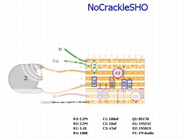

Hi guys, I'm doing my first ever build with this vero layout. I have a question regarding D1. Is it possible to substitute this with either a 1n4001 or an 1n5819 (same as D2)?
The reason I'm asking is because I'm (obviously) a noob at this, and because I made a mistake with my parts order. I got a Zener with a way to high voltage. I could rush to the store and get a suitable zener, but that would be tomorrow, because it is sunday. I'm itching to try this baby out, so could you help me out on this one as soon as possible?
Thanks in advance, Dirge.
edit: the funny thing is, I see now that the original schem has a 1n5819 as D1. D2 just says 12v.

Hey y'all.
I am working on my first build of a stomp box, though I've done other projects in the past. I've tested these schematics through a SPICE simulation, and if that's a hint of what's to come, I'm floored. Doing up a board design now.
Thanks, SoulSonic, for a great idea for a first build.
Edit:
I meant to ask. You'd mentioned getting a non-polarized cap for C2. But I'm having issues finding it. Would you happen to have a part number? Thanks!

keeree wrote:Edit:
you don't have to get a non-polarized. Just use a regular polarized one or bipolar cap.

Post by mictester »
keeree wrote:Hey y'all.
Edit:
You don't need a non-polarised capacitor there - an electrolytic rated at 16V or 25V will be fine - the positive end goes to the FET. You've also missed out the current-limiting resistor for the LED - put the highest value in there that you can get away with (to minimise current consumption) - start at 2k2 and go upwards so that the LED is just lit enough to be clearly seen on stage!

Post by keeree »
mictester wrote:You don't need a non-polarised capacitor there - an electrolytic rated at 16V or 25V will be fine - the positive end goes to the FET.
I don't think anything being seen on stage will be an issue for quite a while, as I'm not very good yet. :slap: However, I asked Mr. Google, and I found a compatible part. I remember Soul Sonic saying on the second or so page that it's best just to get the part in the specs. It's a few cents either way, so not a big issue. UVP1E100MDD1TA is the one I found off Mouser.
mictester wrote:You've also missed out the current-limiting resistor for the LED - put the highest value in there that you can get away with (to minimise current consumption) - start at 2k2 and go upwards so that the LED is just lit enough to be clearly seen on stage!
As far as the resistor on the LED, it wasn't in the schems I pulled the bypass from, but then again, the schems were a little light in general. Could be why the sim never seemed to run the LED right... Not that I 100% trust a simulation... Thanks for the look-over. :D

Post by Cortex »
I built this several times and it is my favorite incarnation of a SHO type effect by far. the only drawback for me is that it has too much boost even when the pot is turned completely down. any ways to resolve this? i never took the time to examine the schematic properly, but maybe by fiddling with the R4 resistor?
earthtonesaudio
Posts: 1244
Joined: 28 Jan 2008, 04:00
Completed builds: Metal Simplex, Fuzz Factory, two Fab Echos-modded, Noisy Cricket, Earth & Space Wah, TS-7-modded, passive xover/splitter box, opamp fuzz
Location: Bloomington, Indiana
Been thanked: 75 times
Post by earthtonesaudio »
Swap the 1M pot for a larger value to get a lower minimum gain, but retain the maximum available.
