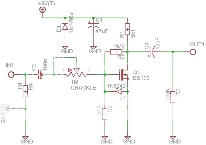

ei guys, I adopted madbean's and soulsonic's ideas. The diode protect (1N400x or 1N5819) is parallel with the power source instead of series connection. One-Mega ohm resistor is added as pop resistor. Will this one work out fine?

Yep that looks fine, cacophony. Just one thing to keep in mind, the "parallel" protection diode like you've shown will only protect the circuit from a reverse voltage as long as the diode can handle the full current of the power supply. In this instance the 400x is preferable for it's power handling and there's no reason to use a Schottky diode unless it's a high-power type.
If you over-current this diode with a reverse connected supply, eventually the diode will burn up and then you have no protection. The "series" protection diode has no such problem, but as I'm sure you know the voltage drop is the main drawback.
For series protection without the voltage drop, you can use a PNP with some support circuitry or a P-MOSFET as a switch. There's info on both of these on GEOFEX if you search for "polarity protection."

You mean I can't use a Schottky diode in parallel to power source as a diode protect? In diode protect, is it always preferable to use a rectifier diode in parallel to power source and a Schottky diode in series?

cacophony wrote: You mean I can't use a Schottky diode in parallel to power source as a diode protect? In diode protect, is it always preferable to use a rectifier diode in parallel to power source and a Schottky diode in series?
looking at datasheets, 1n5819 has a small reverse voltage blocking at ~40v, also a relatively high reverse current leakage at ~1mA, so it's not well suited for that configuration, against the 1n7000 wich has 1000v reverse blocking and reverse leakages in the order of uA
You shouldn't call the gain control "Crackle" because it doesn't crackle! :P
I also think that if you use a parallel reverse protection diode, it's best to use a low-value resistor in series before it... say 10 to 20 ohms. That way you don't get hardly any voltage drop, but the resistor acts as a simple fuse in the case of major faults.
