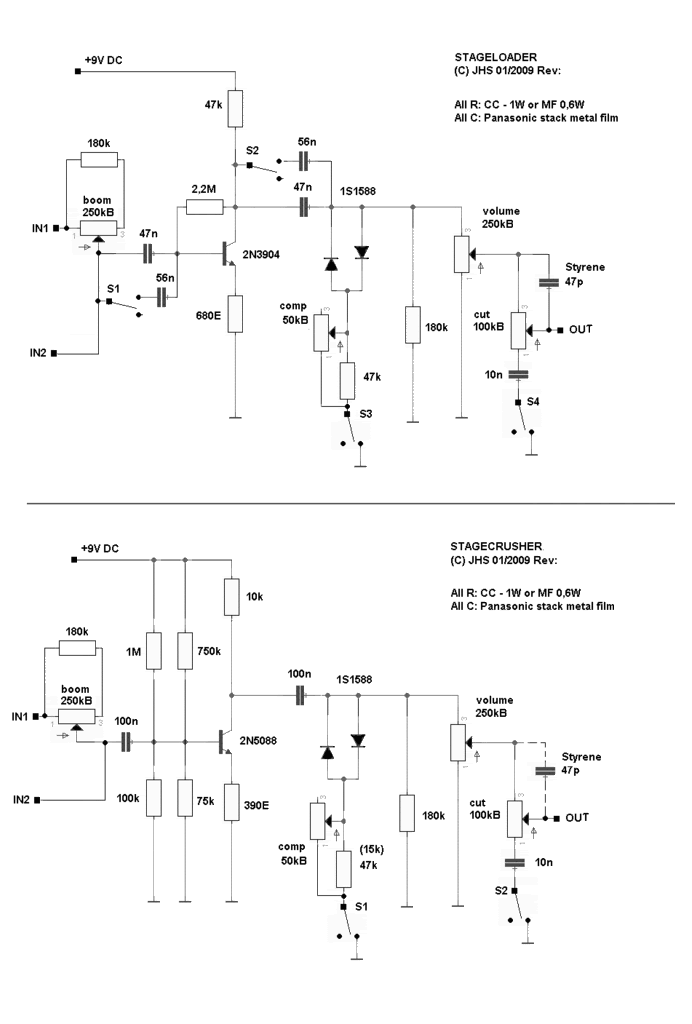

I wish more people drew up layouts like that

Looks indeed like an Electra with an input gain control, a volume and a tone pots.

something I've never liked of the electra is that's too much sensible on the input, use a buffer in front or push it with a booster and it will start to fart out...much better if you add some kind of resistor to ground after the input cap, with 2M2 from the collector a 390k to ground works well to me..if you loose some gain a bypass cap on the emitter res will do a good job too.

On that tone control in the first diagram, are those caps coming off the lugs just soldered to the side of the pot? Or am I missing something?

one leg of the cap is soldered to the lug on the pot, the other leg to the bottom of the pot.

So I have an actual Greer Ghetto Stomp. Its great. It has a huge booming low end, which I adore. However, sometimes that huge lowed can become muddy in certain situations. I'd love to but a bass cut switch on this guy. Would it be best to put a switch on the input or output cap? Which one is causing that huge low-end?
Re: Nick Greer - Ghetto Stomp
Posted: 09 Aug 2012, 19:06
by juanro
Possibly both, but I'd try first with the input. The .1u cap is fairly big for that position... try switching it (with a SPDT) to .01u or if that's too little, perhaps some intermediate value (.022u , .033u)
