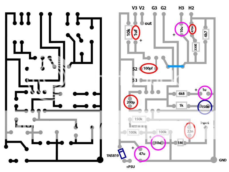

great sounding overdrive, nice dirty jangle in the lo gain setting, and then HEAVY and thick without mucking up at all. i built it into the enclosure i had originally used in my lovepedal pro valve build, with a 2nd footswitch adding a resistor in series with the pin2 side of the drive pot. i definitely needed the tone pot playing my strat thru my vibrolux, still tweaking the swtc values. my buddy plays lps thru marshalls, he's a treble junky and i bet he'd love it like this
quick question, i remember when i was comparing your pcb layout to your schematic, the pcb i think has a 100n cap parallel with the 1uf output cap? does putting these in parallel serve a special purpose besides giving you a 1.1uf output cap? i only ask because i've seen similar configurations of caps to ground in power filtering, like in some lovepedal designs (purple plexi, super six) a 47uf parallel with a 100n to ground. i dont know what the rationale of it is, but i doubt it's to achieve a 47.1 cap! just curious. i was out of 1uf's and used two 2.2ufs in series, hoping that was serendipitous.... cheers on a great pedal
- soulsonic
The reason for putting a lower value film (or ceramic) cap in parallel with a large electrolytic cap is because electrolytics usually have poor performance at high frequencies, so the smaller cap isn't there to change the overall value as much as it's there to help the highs to sound better.
You see it used in power circuits to help reduce high frequency noises. It's for the same reason; because of the bad high-frequency response of the electrolytic, but it's used in that case to help reduce high frequencies in the DC rail. The trick for it to work well in that application is for it to be located as close to the power supply pins of the opamp as possible. They even make sockets intended for logic chips which have this cap built in.
So anyway, you can include that cap if you want in the Hunny Bunny, but it's not absolutely necessary. You can feel free to experiment with a variety of different cap types.

I also made a vero layout, without any mods. Mine is lacking the protection diode, but a bit simpler of a layout.
I rather like my practice of reversing the layout and putting huge red circles on to indicate trace cuts.
Do BS170s in layouts like this needs static protection diodes like in SHO-style circuits?

madbean
Back home form my vacation, but too sick to work today. So, here was this morning's effort at firing my layout chops back up after two weeks away. I didn't include the schem...same part names I think as Martin's, except I added an LED and CLR.
Enjoy!
Oh, and I haven't built it yet. But, I'm looking forward to it....thanks, SS!
Enjoy!

I'm always impressed by your layouts. What program do you use? I like the accurate component outlines.madbean wrote:Oh, and I haven't built it yet. But, I'm looking forward to it....thanks, SS!
You probably want to add some sort of tone control though.
madbean
Thanks! It's Eagle, with a few customizations to the gaussmarkov library. A treble bleed could be added pretty easily offboard before the volume pot, but I might add a revision to the project for that. Or, would it make more sense before the mosfet to provide some gain recovery? I skimmed through this thread, but didn't read too deeply into the tone control discussion. SWTC is also a good option, of course.Brink wrote:I'm always impressed by your layouts. What program do you use? I like the accurate component outlines.madbean wrote:Oh, and I haven't built it yet. But, I'm looking forward to it....thanks, SS!
