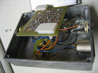

The 'Triangular Ear' (Behringer) Bass21 would be the Behringer BDI21 which is supposed to be a simplified clone of the Sansamp Bass Driver DI.
I build mine from the same schematic by Diz and it works fine, but I did do my own PCB layout.
I'll try to upload my layout and some pictures of the finished product today...

The schematic in this post doesn't have the ground lift on the XLR output anymore and I think the bypass switch lookes messed up.
The original schematic (http://home.planetahost.ru/~firewood/teb21.pdf) has this black box of FET based switching but there is another version which has that replaced for true-bypass: http://www.geocities.com/george_giblet/ ... te_v10.png.
As I don't consider this a 'stompbox' but a DI box or even pre-amp, I didn't put an 'expansive' switch into mine. I also ommited the Blend control as all the cool presets show the blend at max.
gkoerselman
Posts: 81
Joined: 08 Aug 2008, 06:58
Location: Germany
Been thanked: 39 times
Post by gkoerselman »
I split the balanced XLR output onto a second board because I was afraight it would otherwise not fit in a BB enclosure. Advantage of this is of course that the whole XLR output could easily be ommited.
Here are some pictures:
If anyone is interested, I recommend they send me their e-mail address so I can send them the Eagle files.
This is not an easy build and considering the Behringer only costs 40,- or so it might not be worth it...
