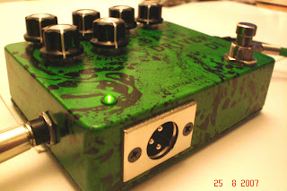

Hello!
That layout was done by a friend of mine in Chile, 12afael, who's the creator of Plexilandia (main DIy forum in Chile, and probably SA) I actually was the beta tester of that layout when I was living there, and it works fine. I've compared it a Tech21 BDDI and IMO sounds exactly the same ;).
The Phantom/GND Lift section can be added with a 100ohms resistor for current limiting and a 8,2V Zener and a SPDT switchere.
Here's a pic from baaack then :).

darkglass, where would the 100 ohm and zener go? i'm a bit thick when it comes to XLRs. is this for phantom powering the unit or something? would be useful with my interface at least, since i never gig. if it isn't too much bother, could you draw up a schemo?

Sorry for the huge delay, I wasn't aware of your question until 1 minute ago :).
The 100Ohm would be in series with 9V (therefore in series with the battery and DC Jack) limiting the current for the Zener, which would be in parallel with the power supply (look for any Zener Regulator circuit in google and you´ll see an schematic) The advantage of using this technique in this case is that both zener and resistor worsk as reverse polarity protection, current limiting (less current consumption when battery used), and in this case also phantom voltage regulation (from 48V to 8,2V).
Hope you got it.
Regards
