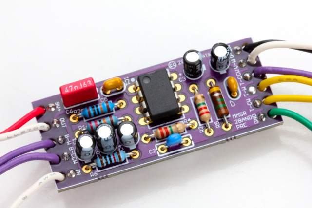

Since I did my own boards, I do not know (mine are partly smt), but maybe wait until you have the boards and order parts at a hobbyists shop like smallbear? Resistors is usually not a problem, but the is some variability in electrolytics (tall vs fat, different leadspacings), and also film caps can vary a little bit depending on foil type (and can be A LOT bigger for high voltage versions)

I have LM4250CN IC's, and the OSH Park boards are on the way. I just need a list of what else to gather and I am not sure if the Mosuer parts list is 'up to date' with respect to the discussions and revisions mentioned in this very long thread!

Jarno - do I just use what is marked on the PC board(s) to develop a part list? Remember to presume that I am a total novice!Jarno wrote: ↑16 Sep 2021, 05:53 Since I did my own boards, I do not know (mine are partly smt), but maybe wait until you have the boards and order parts at a hobbyists shop like smallbear? Resistors is usually not a problem, but the is some variability in electrolytics (tall vs fat, different leadspacings), and also film caps can vary a little bit depending on foil type (and can be A LOT bigger for high voltage versions)
Also, what is smt?

Surface Mount Technology, so surface mount components, as opposed to through hole.
And yes, if the values are on the board, you can use those values to make a partlist.

By the way, I had a look at the talkbass thread, which is mentioned in the OSHPARK link, and that has a mouser BOM which seems to work.
The 4250 you need to source elsewhere, but other than that it seems to work, a few obsolete components for which they still have stock (and you could use that datasheet to find a suitable replacement).

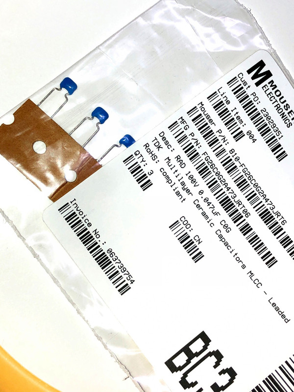

A picture of the parts you received? It might be that there 1/8watt resistors on the bom, which are about half the size of the more common 1/4watt ones

The caps from mouser are 0.047uF, which is the same as 47nF. They look different, because they are ceramic capacitors, rather than film capacitor in the picture from the board.
I myself very much prefer film capacitors from anything passing audio (I do use ceramic for powersupply bypassing at opamps and such).
This is the one from the picture:
https://nl.mouser.com/ProductDetail/WIM ... XkHA%3D%3D

Start with the resistors, then capacitors, semiconductors (IC's, transistors) last.
But in general, lower/smaller components before bigger ones.
