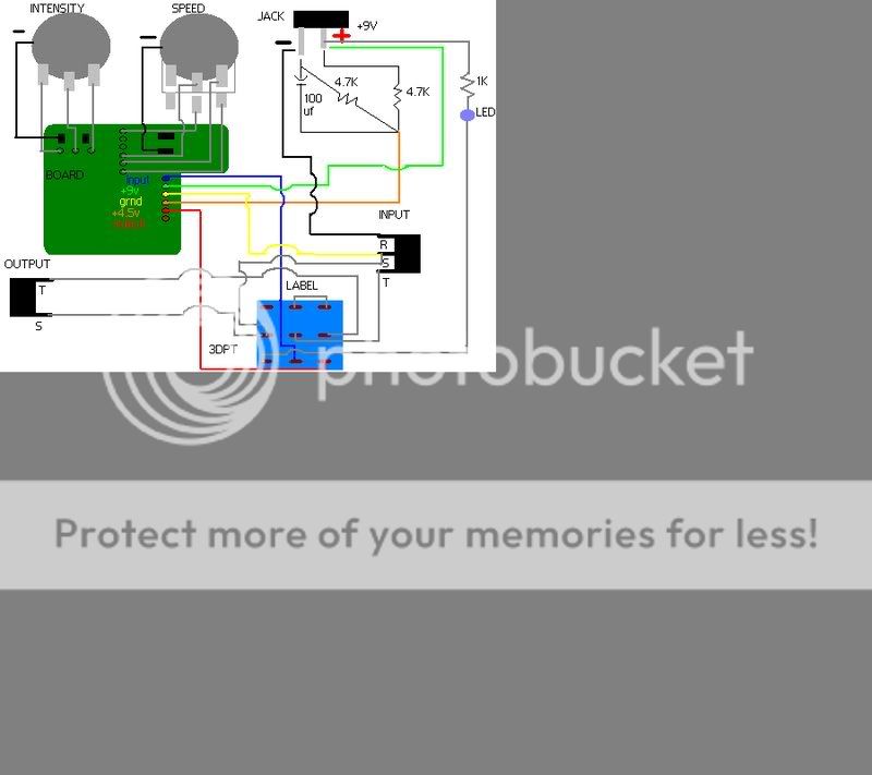

Alright, I'm at school so i couldn't snap a pic, but I drew up this wiring diagram. This is the exact way that I wired up my pedal, so if there is anything wrong here, it's wrong on the board.Image

Post by Barcode »
1986lespaul wrote:nothing?
if your diagram is accurate, you have the 4.5v bias supply wired where your circuit output goes, and you have the circuit output wired to nothing...

Post by 1986lespaul »
no, it's right. The labels got shifted down slightly. I have the 4.5 volts going to the bias supply and the output wire going to the bottom right pin on the switch.

Post by Barcode »
1986lespaul wrote:no, it's right. The labels got shifted down slightly. I have the 4.5 volts going to the bias supply and the output wire going to the bottom right pin on the switch.
then it looks right to me. I'm afraid the issue may not be wiring, something might have gotten damaged while doing the rehouse...
