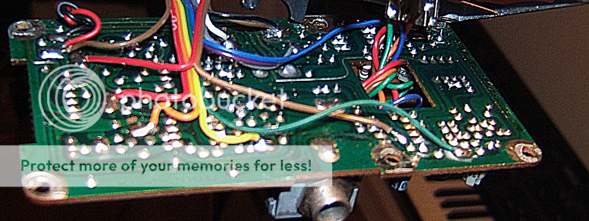

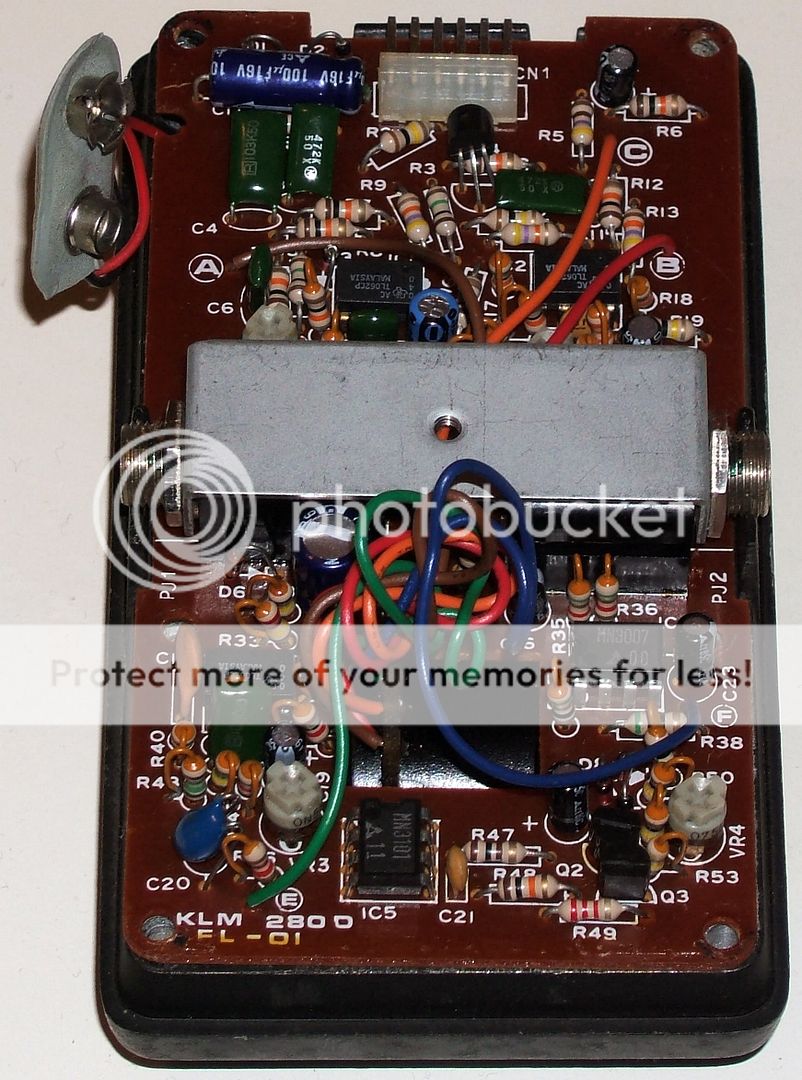

Sorry for the fuzzy pcb-side shots. It's almost 1am here...
To display the images in their entirety, right click and hit "view image"

i had this flanger 5 years ago........very nice sound.........
thanks for pictures

I just got one of these in this weekend... I was going to take some gut shots, but it looks like I was beaten to the punch. Some great shots already here. :thumbsup
