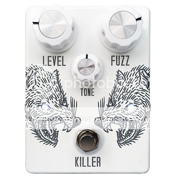

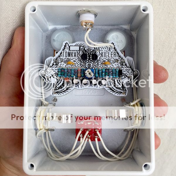

Hey everyone. I know this is an old thread and all but I'm a small pedal builder from brooklyn, ny and I make a clone of the fuzz-stainer. Heres a few pics.
feel free to ask me any questions about it.
Nocentelli
Posts: 2211
Joined: 09 Apr 2009, 07:06
Location: Leeds, UK
Has thanked: 1115 times
Been thanked: 939 times
Post by Nocentelli »
tomk wrote:feel free to ask me any questions about it.
Why don't you use the unused lug of the footswitch to ground the input in bypass?
tomk
Posts: 3
Joined: 25 Mar 2013, 03:51
Post by tomk »
I haven't had any noise problems in bypass and haven't had any reports from any of my customers so I wasn't doing it for a while. Probly wouldn't hurt to do it tho huh?
