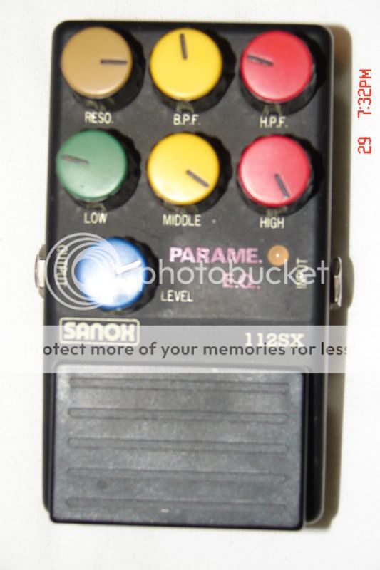

heres mine
bonus heres the parametric eq I scored at the same back woods music store in arm pit tennessee from the same company that made the synth
they were both BRAND NEW AND NEVER BEEN OUT OF THE STORE. got em both for 60$.
